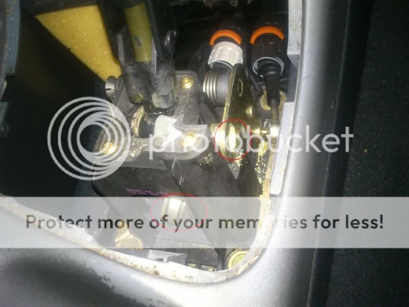

Maurice, before you go, check what setup you've got. Take a picture if you need to so we can see what you have.
Don't worry if it's the crown washer type - I'm sure I can get hold of them for less than the price quoted above. It's just best to be prepared, especially when you're miles away from home.
If you do have that type, please let me know and I'll see what I can do.

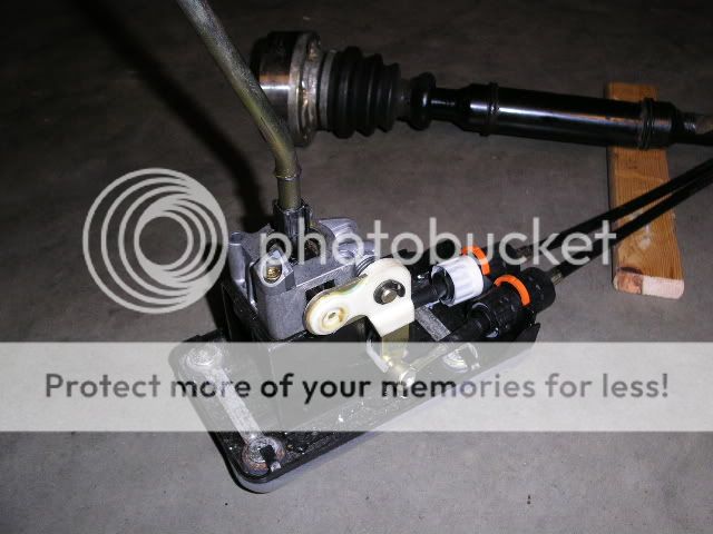

Iirc the plastic washer type used on later /C2 was about £17. I'm sure i posted the info in the FINIS codes thread at the time, along with part No's.
It's also worth noting that both gearstick assemblies are interchangable. 4 rusty bolts under the floor will release the assembly.
Early alluminium type with steel "C" clip:
Later plastic type with the plastic "washer" on the opposite side of the turret, by the yellow foam.
