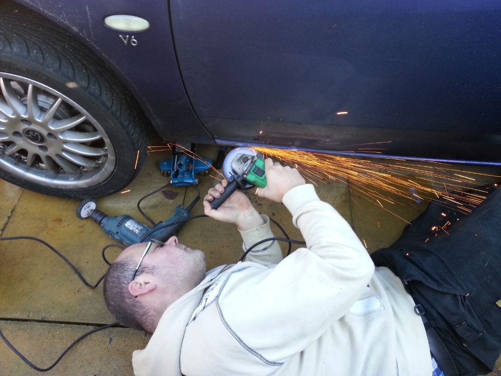

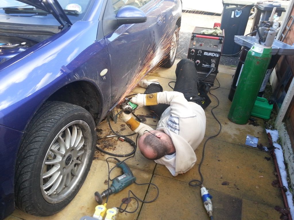

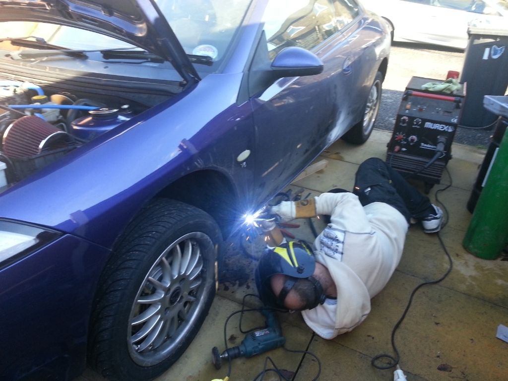

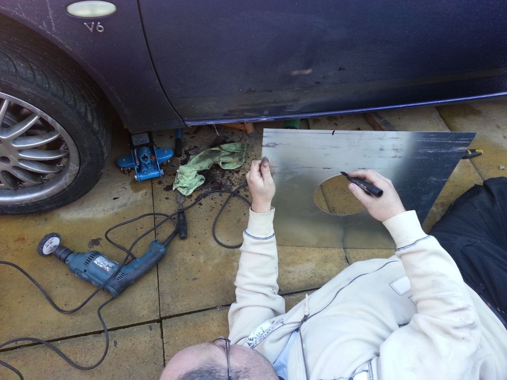

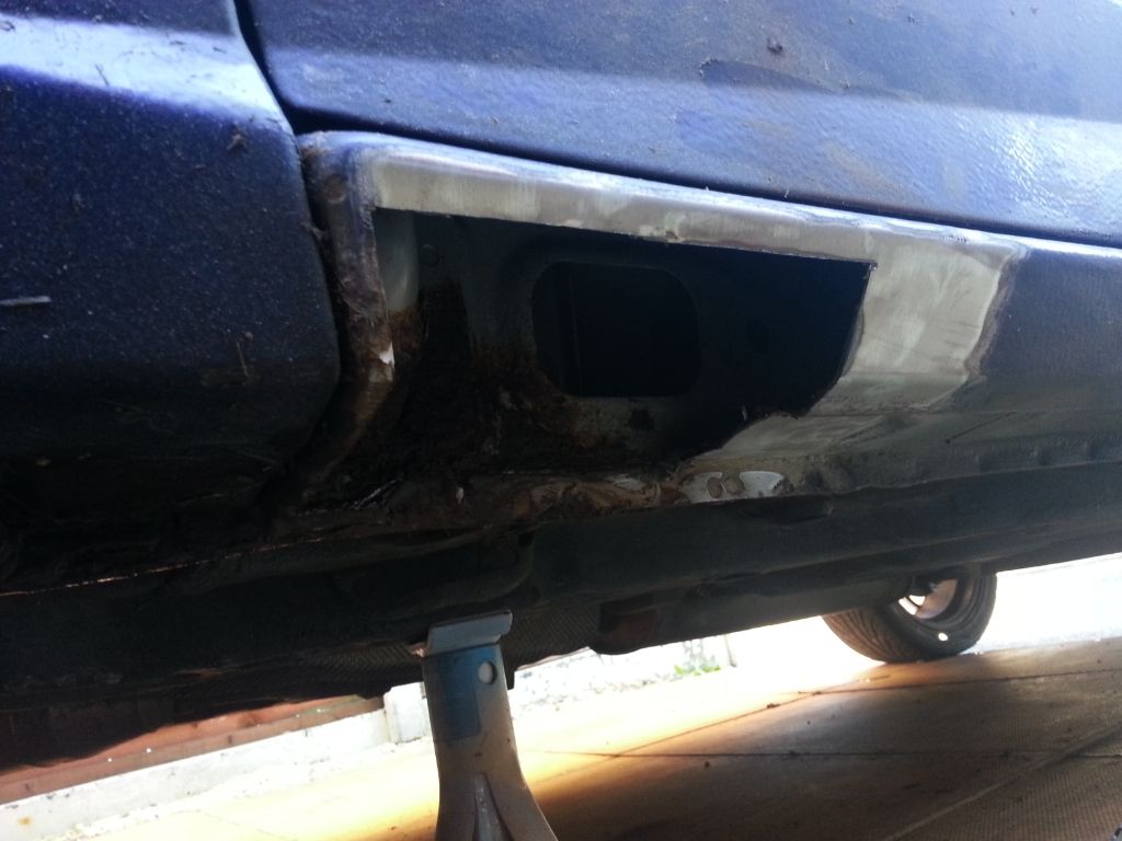

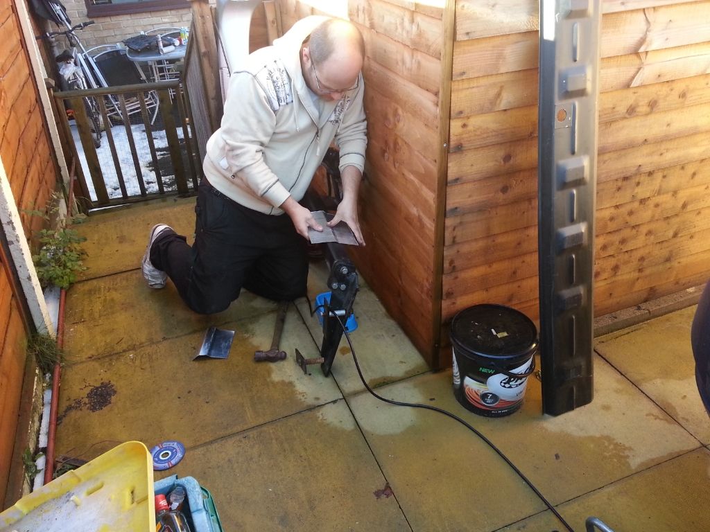

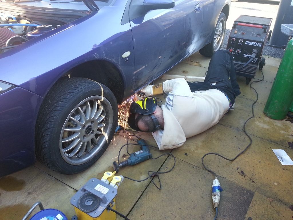

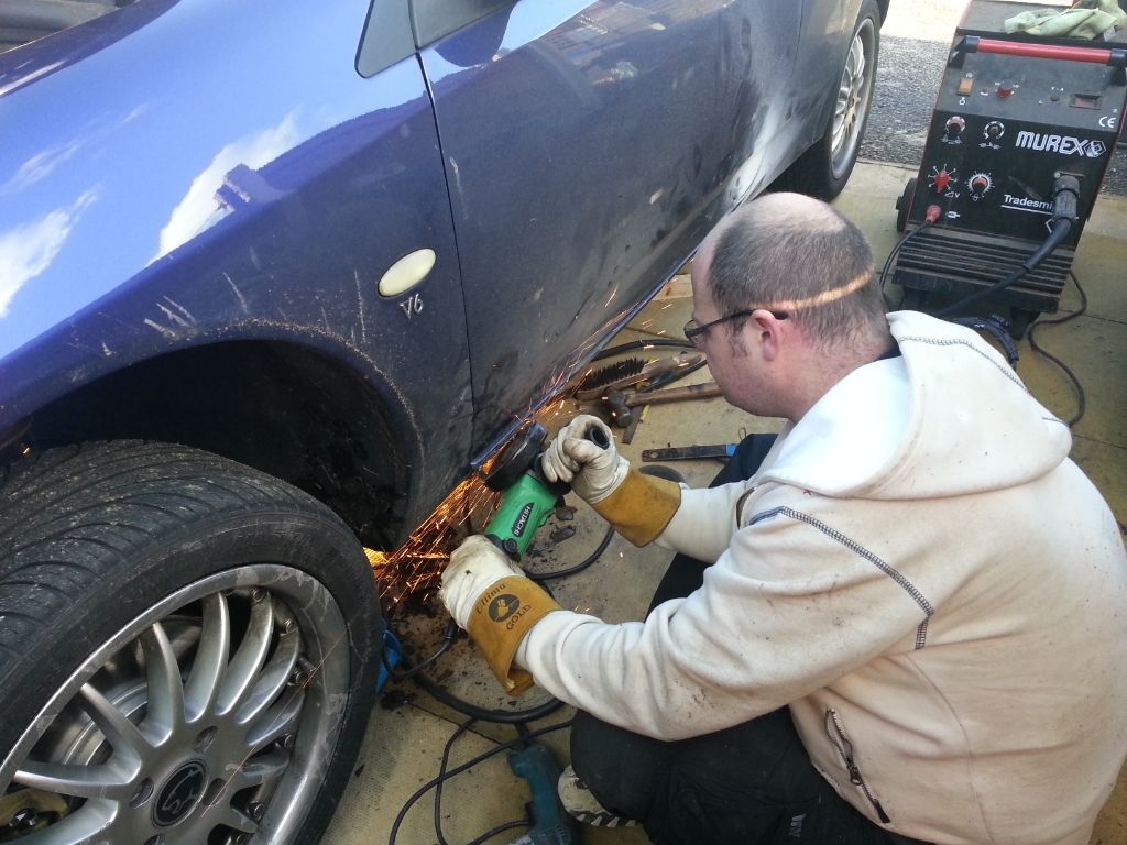

Cheers for your replys chaps! It was nice to catch up with rich again, and to see his face when I cut a gaping hole in his car was priceless lol.

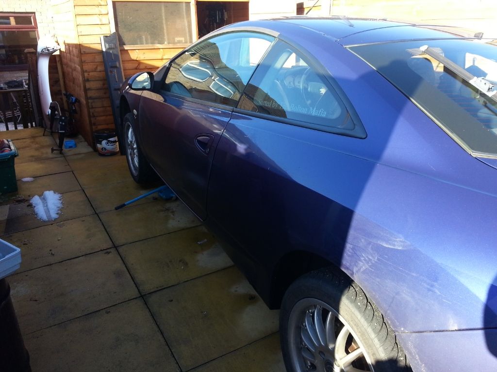

It was a dam cold day though, in some of the pics you can see small patches of the hailstone that fell the previous day! It took most of the evening to defrost my feet! Steph did great though supplying us with tea and pig!

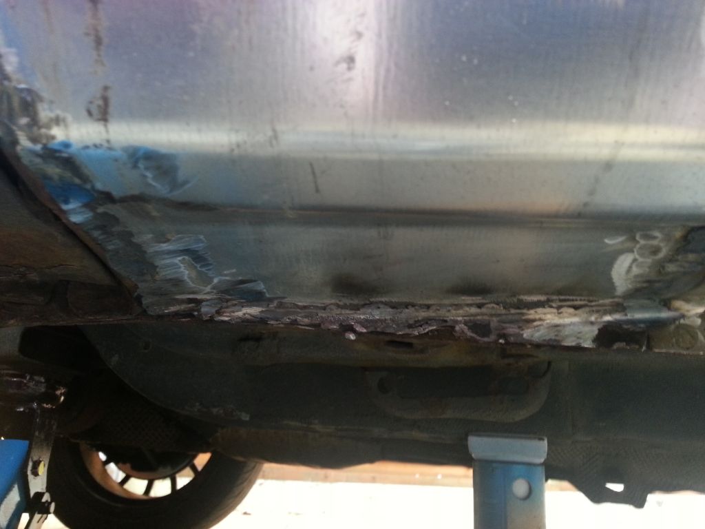

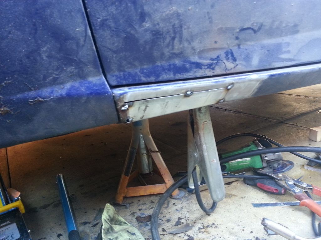

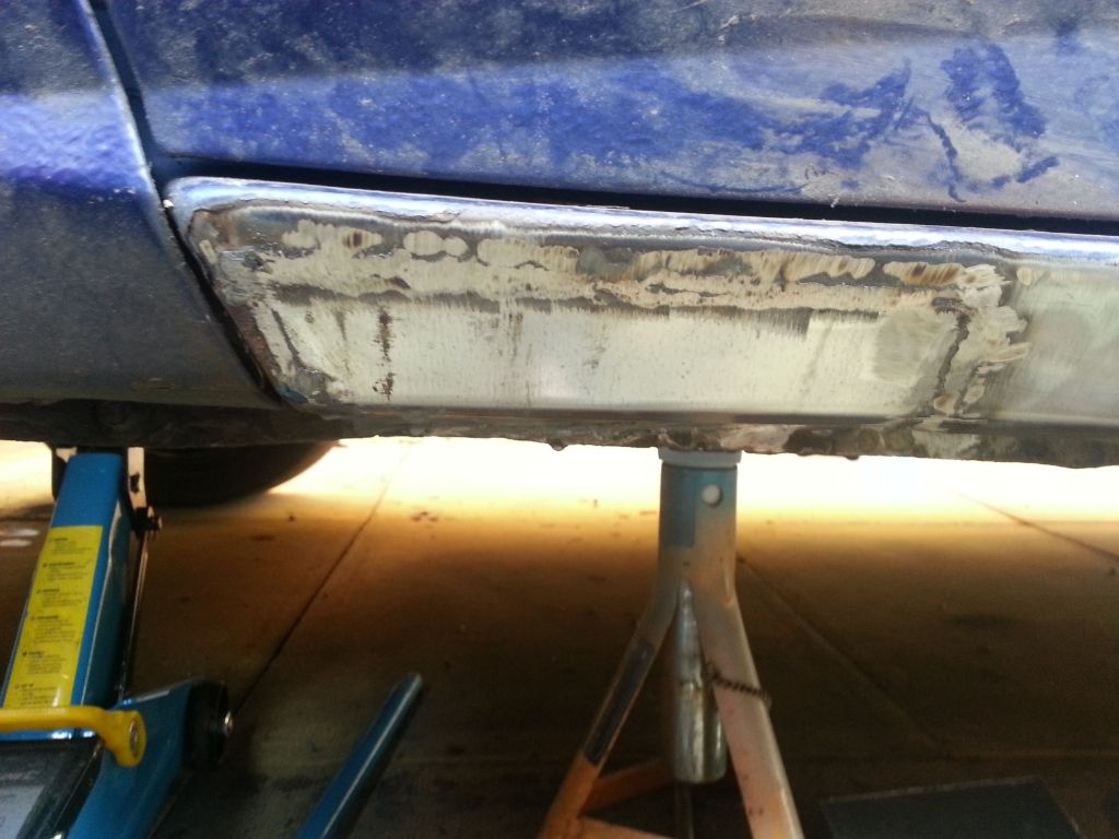

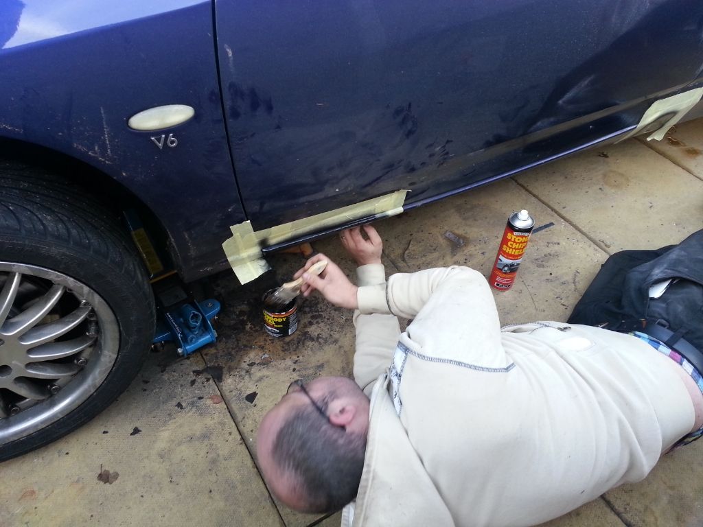

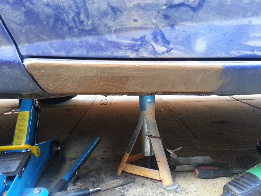

I would have liked to match the finish to the bodywork but as advised by rich, its going to have some paint whilst in storage so I just slapped some primer over, then a dose of spray on stone chip, and a good dollop of underseal underneath to give it a little protection on rich's long journey home, and gave him a tin of the stuff just incase it it didnt survive the journey
