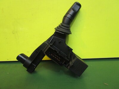

Perhaps this picture showing the HAZARD button on top of the steering wheel puts it into perspective ? The relay is over on the right in this picture. Its also black so harder to see, but its plugged into the switch assembly as seen in the first picture posted above.

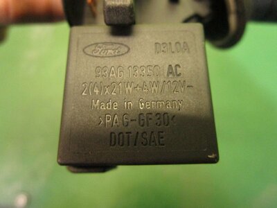

Or this one where you can see the top of the relay at bottom right :-

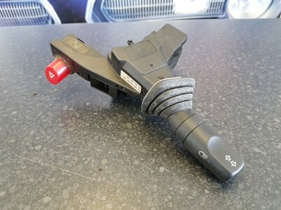

Here :-

Antonio, the relay in question is not in the fuse box but is attached to the indicator stalk as shown in a couple of the photos Foobar has kindly copied from the eBay link in post no2.
In order to access the relay you will need to remove the covers(shrouds) from the steering column.
