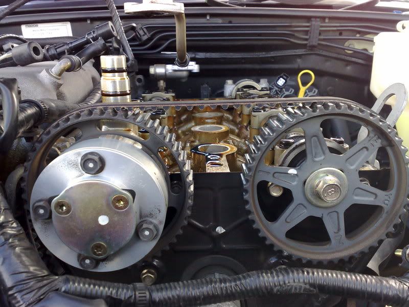

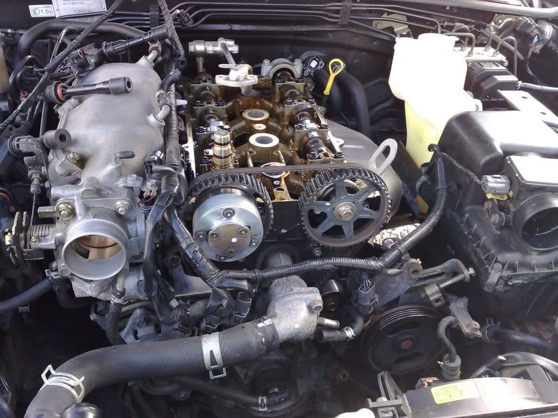

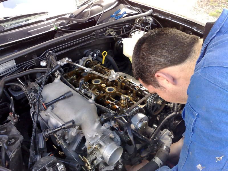

Anyway, you'll see from these that compared to the Zetec Cougar, access to the timing belt is excellent. The downside is that you have to remove the rocker cover to get to it
You'll see the variable valve timing gear and oil feed on the inlet cam there

The more observant amongst you may notice that I cheated with the timing belt and cut it in half round the circumference by giving the engine a couple of turns on the starter motor. I then slackened the tensioner, removed the "front" half of the belt, fitted the new belt, then chopped the "back" half of the old belt and removed it before sliding the new belt fully home. The tensioner and idler were then changed one at a time and job's done. No faffing about looking for timing marks etc
