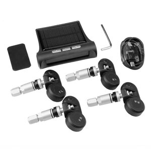

The two sensor options are :-
External, where the dust caps contain the sender units...
...and Internal, where the sender units are inside the tyres.
The advantage of External is simplicity to fit, the disadvantage is possible damage, loss or theft. Plus, since they have to be secured by a locknut, they are fiddly when it comes to topping up with air.

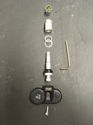

Conversely, the Internal sensors are difficult if not impossible to fit yourself and likely to cost a 'valve and balance' per wheel, assuming you can get it done. Even then the fitter needs to know how to fit them properly without damaging them and likewise whenever you have the wheels / tyres worked on.
I suspect the sensor's weight may also require extra balancing weights over a standard valve / dust cap.

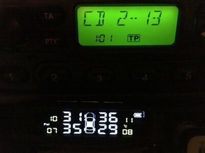

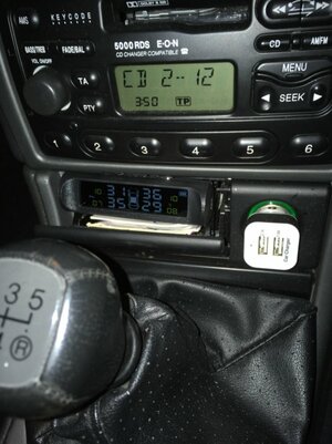

This has all been fitted to the car and the head unit, which is quite small, just happens to fit in the ashtray which I don't use except for business cards ( now removed ). Forgive the odd pressures, this was as I found it and partly why I bought the thing in the first place. I can also say that after a couple of weeks and a 1,000 or so miles, the adjusted pressures have remained steady and consistent. I.e. these caps which are clearly open to the tyre contents the whole time - don't leak. Temperatures on the external units I susepct are nearer ambient whilst driving, I'm hoping the Internal ones will be more realistic. Please note the flash on my phone has made the display look less bright than it really is.
The display is also in various colours not visible in this low light picture ( red, yellow, white ).
