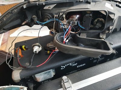

Noel, those 1" holes in the rear covers were to route the HID wiring in. I don't know whether Steve removed them or not, but the car had HIDs for both full and dipped beams, the wiring to the ballasts went through those holes and was sealed by correspondingly sized rubber grommets.
Aha, thanks Rich, that explains what I see. I am a bu993r with the pressure hose, so sorting that out is a priority. Even a drop of water seems capable of removing that silver. Even though much of that is cosmetic, it would soon look horrible. I'll let you know what I find in there, but I only see one HID power supply on each side of the vehicle. Not sure that they are visible in the photos. Maybe Steve upgraded to LEDs. Its hard to say whats there zooming in on the picture...

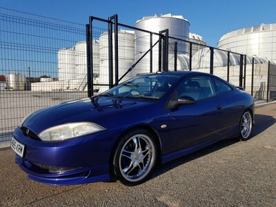

looking at the headlights, what is the extra lamp wired in blue?
It wasn't that roundabout on the corner of the airfield was it? Where there's only one real turning. That gets hit several times a week, and there's been loads of complaints, it can't just be the road layout, there has to be something else going wrong there. And while we're talking of the NDR don't get me started on the three lane roundabouts that are quite obviously marked out wrong but the council will do nothing about it.

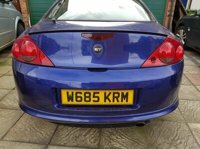

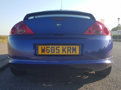

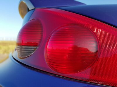

Aside from Norwich problems, the car looks great by the way. Hope to see it in the flesh soon. I spot US spec rear lights? Are they alright for the MOT? Might have to go looking on US eBay...
mabo; C2 headlamps have an extra bulb socket at their outer end to accommodate US running lamps, they use the same type of socket as the wing repeaters. Noel's have been wired as extra indicators though.
David'; I've never had a problem with my US rear lamps and the MOT but found it better to relocate the indicators to the reverse lamp position and use chromed amber bulbs. I relocated my reversing lamps to a remote position in the number plate recess.
I believe Noel's were modified with offset-pin sockets in the reverse lamp position to accommodate twin filament bulbs for the indicators and reverse lamps.
https://forums.ukcougar.club/threads/32814-Pic-Request-USA-Rear-Lights
There's no shortage of them on US ebay but please stress to any seller you might deal with that the corners must be especially well protected for shipping, numerous ones have arrived over here with damage in that area.
mabo; C2 headlamps have an extra bulb socket at their outer end to accommodate US running lamps...
