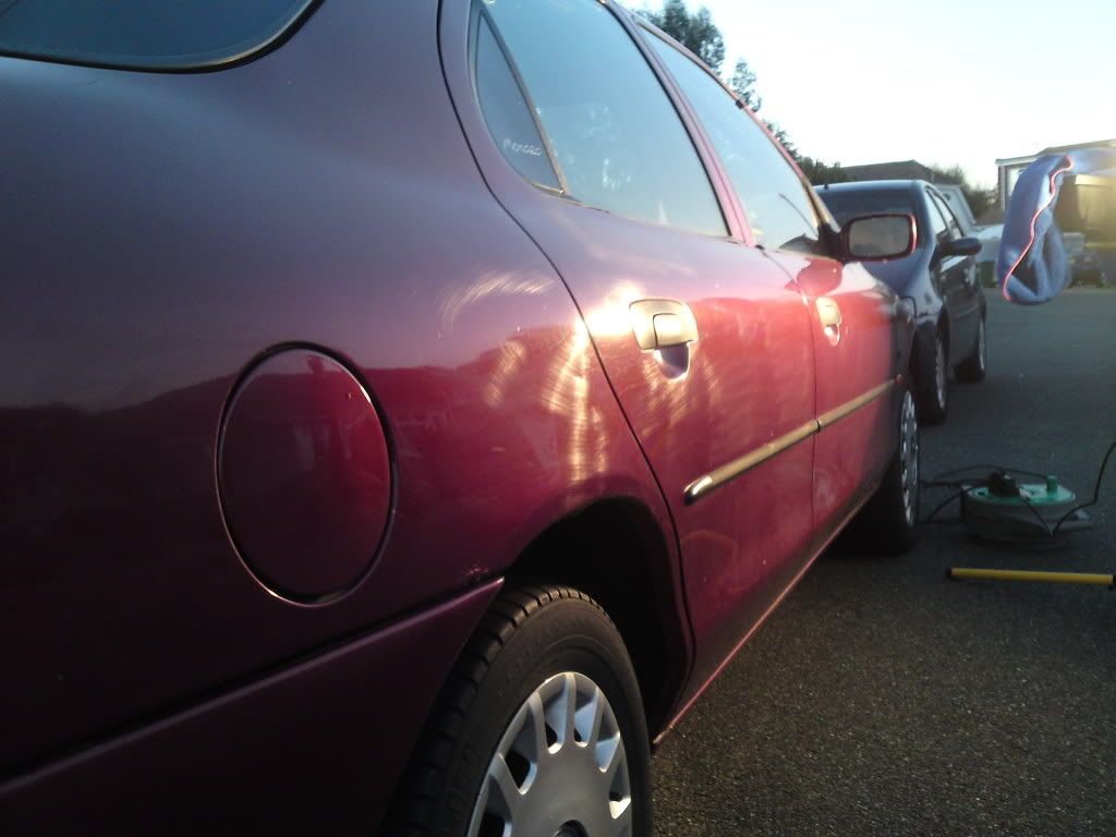

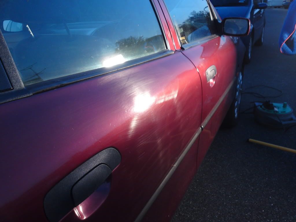

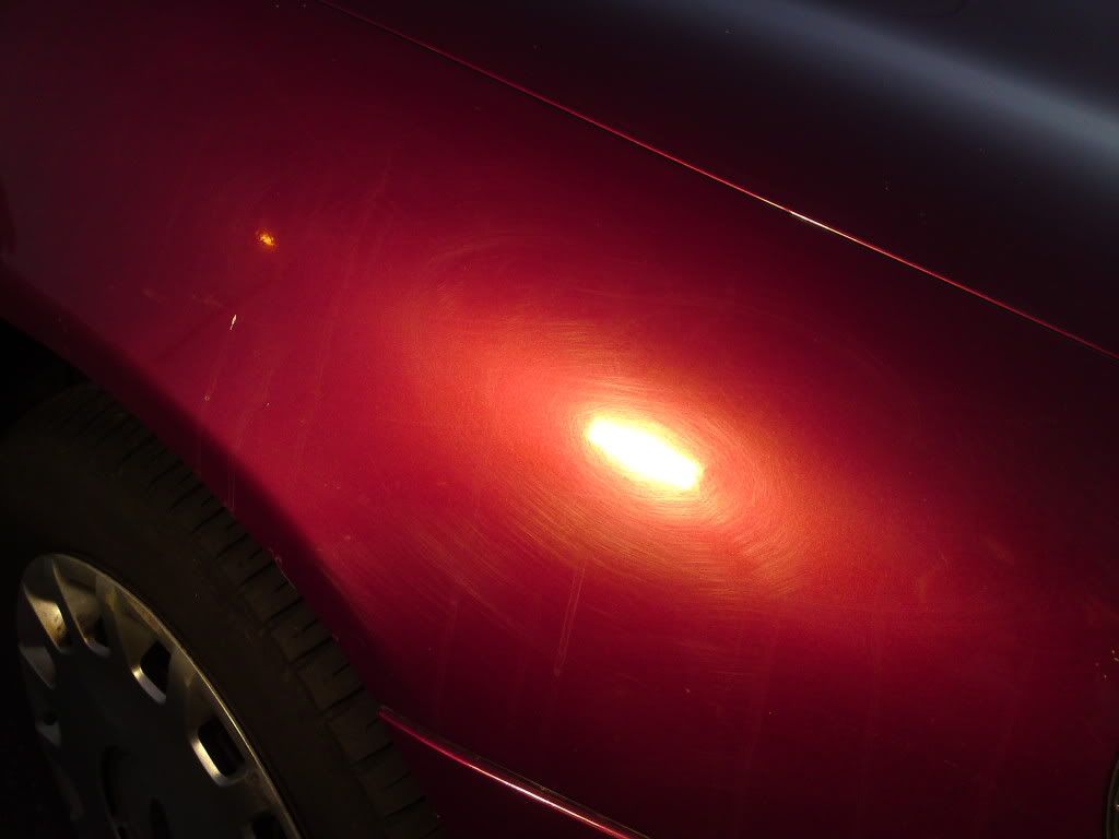

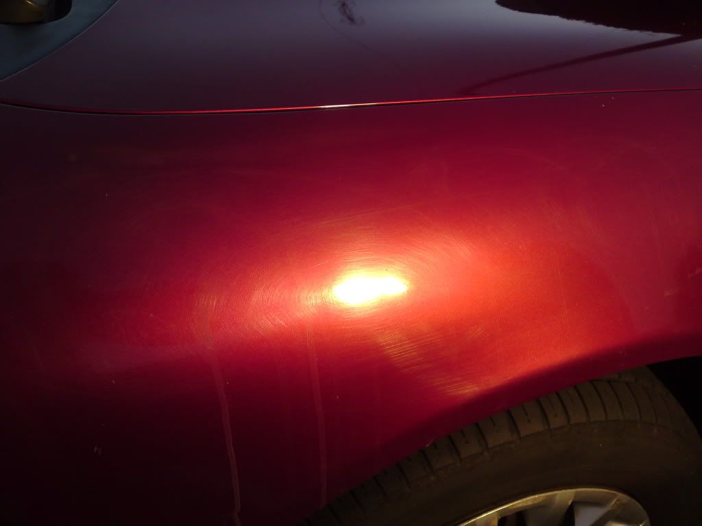

What I was faced with:

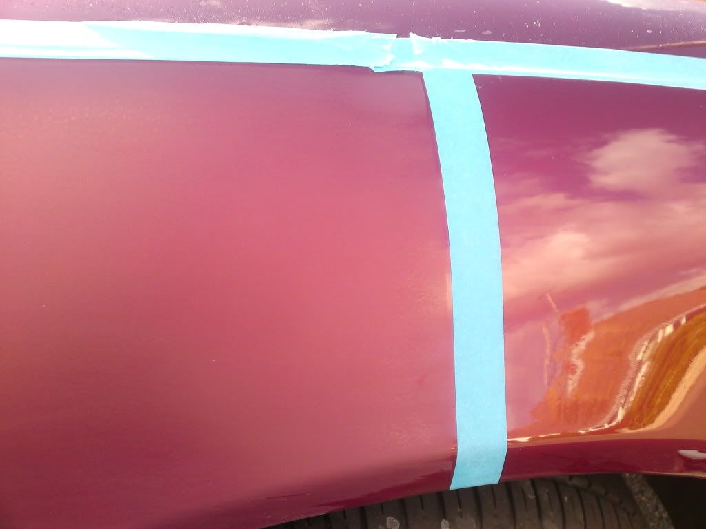

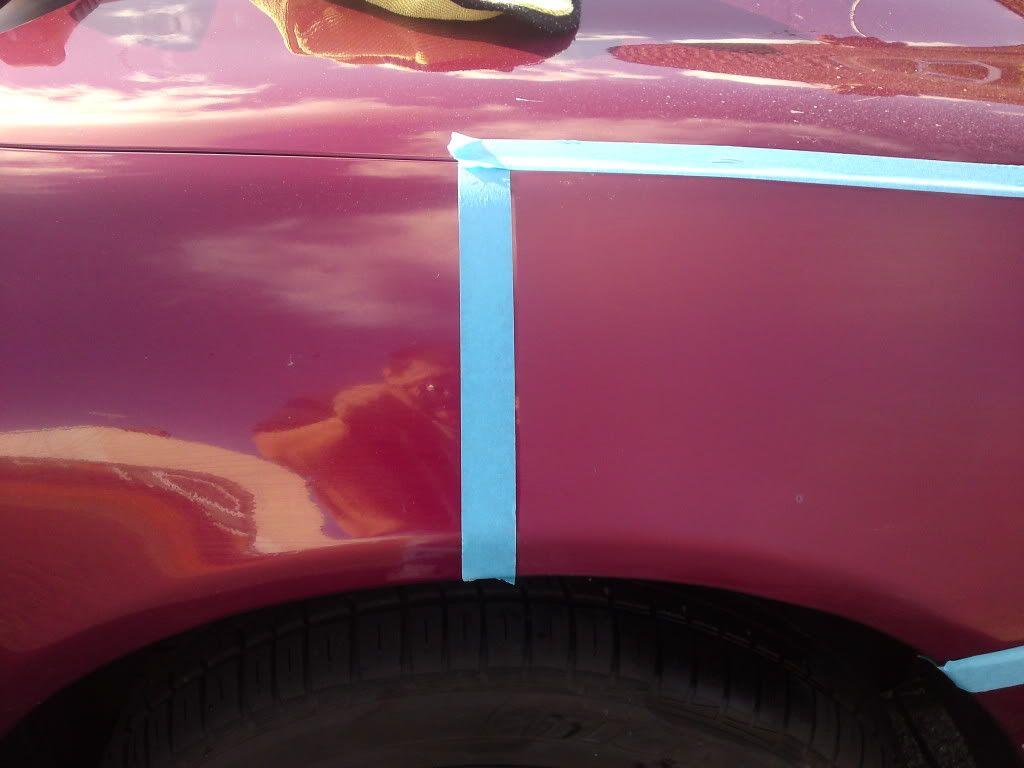

Taped up and I did a small section first to see what grit sandpaper I would need to go down to, to get the level of finish I was after. Considering the value of the car etc, I was aiming for 80-90% correction.

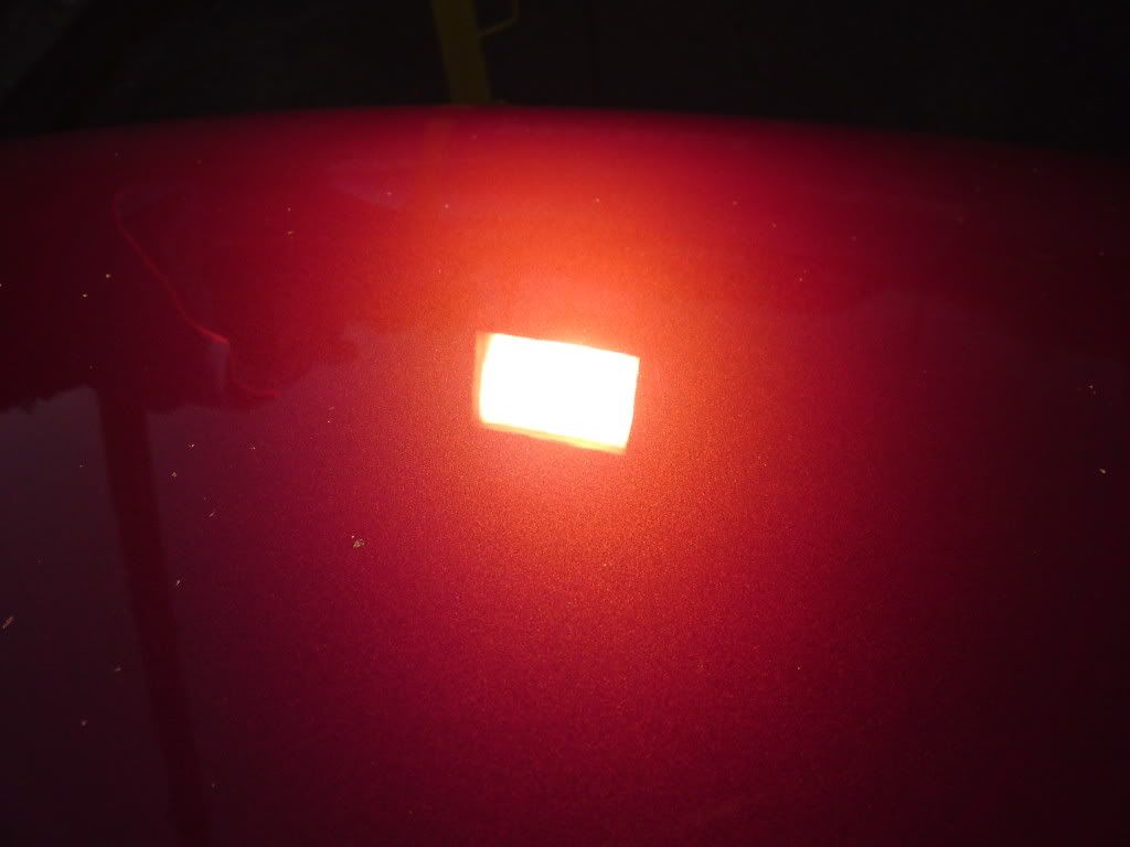

Close up after being sanded:
Even closer up after one pass with the DA and some cutting compound:
Very happy with the result so moved onto the top quarter of the bonnet:
It's at this point the "client" has a heart attack
The same part machined and the tape removed from between top and bottom of the bonnet:

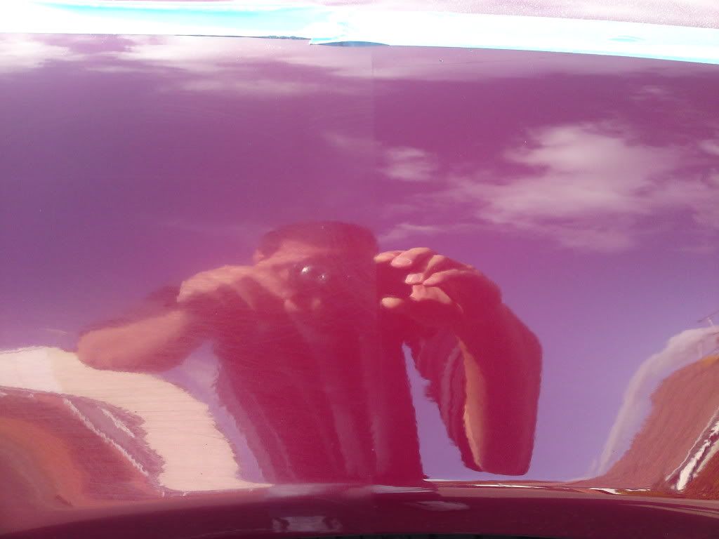

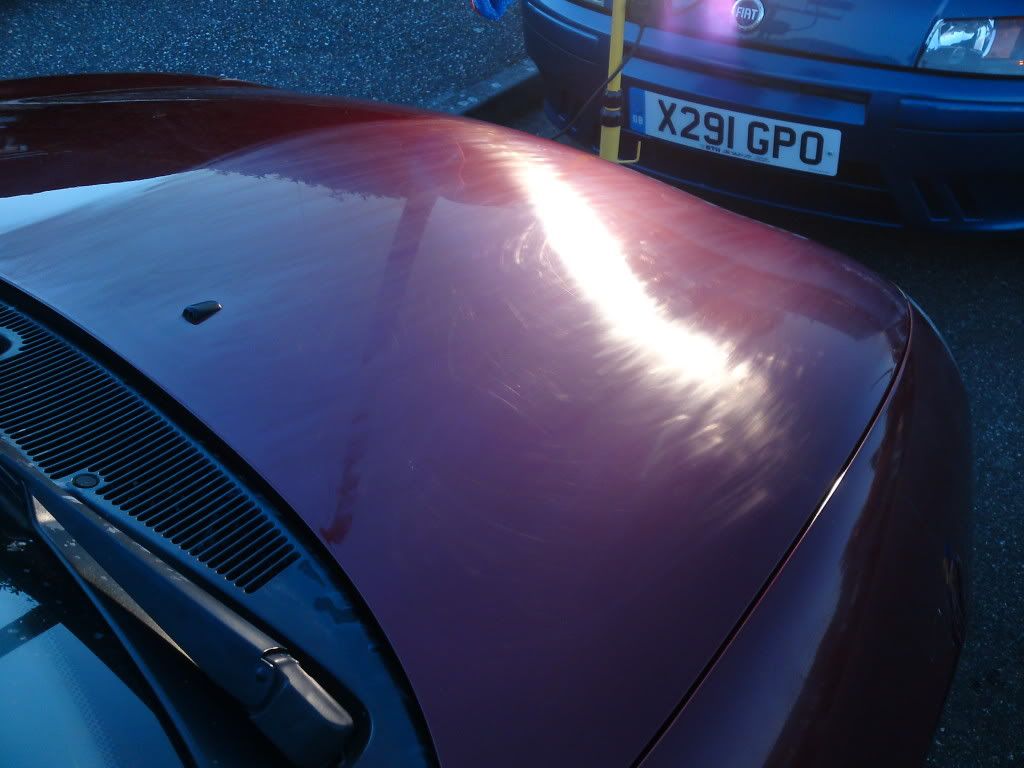

Again, very happy with the result so did the rest of that side of the bonnet:
Check out the shine: :stop:

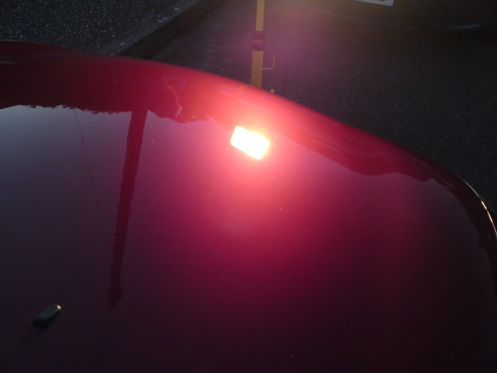

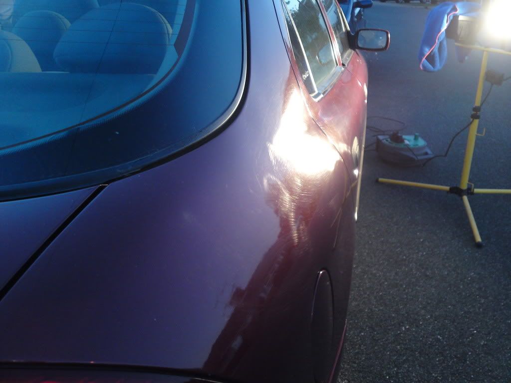

And after being machined but before being refined:
Finished (not waxed) side:
Side left to do:
Overall (sun was going down so not great piccie)
