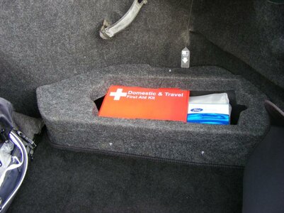

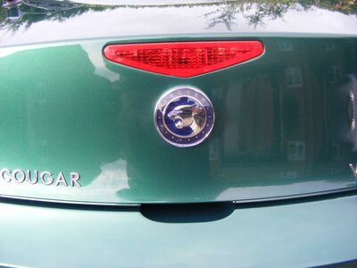

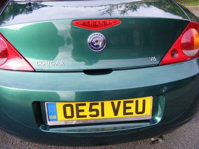

Fitted a new old stock 96 cougar grill badge on the boot, as its from the model before ours and has a curved back it was not a simple fit, two new holes drilled as the studs are wider than the ford badge then the back was bulked out with number plate tape, used apoxy glue on the studs to make sure it did not move then put a band of 10mm wide chrome trim around the badge to hide the gap in the middle, had a cd changer cover in the boot for a while with nothing in it so fitted some corex card inside it the make it stronger then cut the middle out of the top and put the first aid kit in there.
