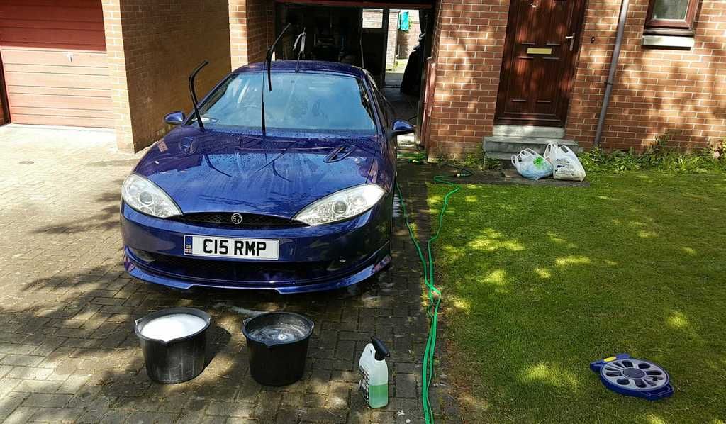

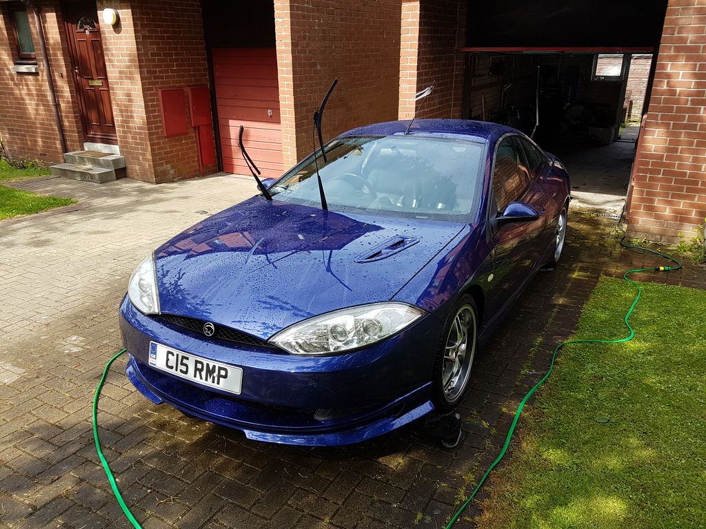

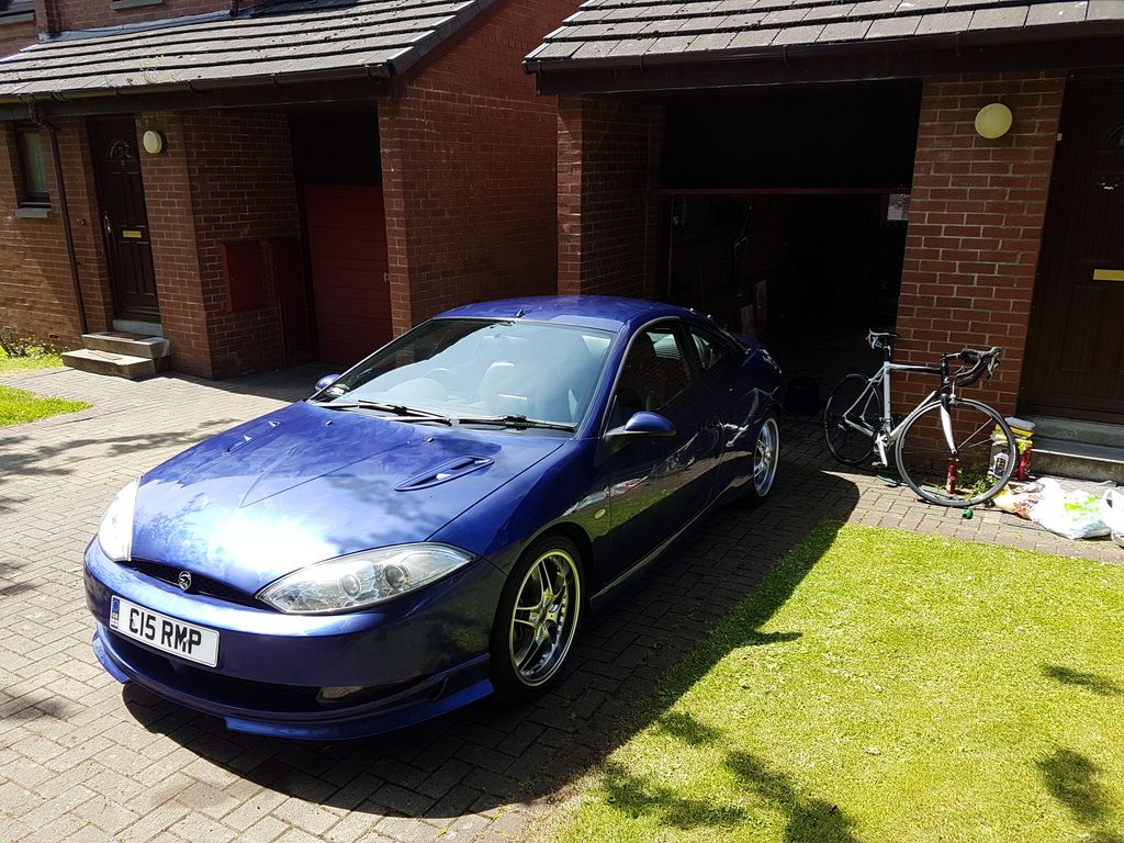

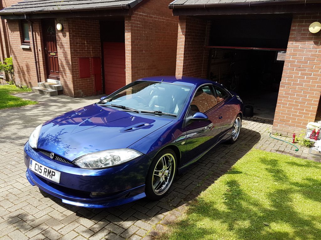

You know there's a show coming up when you spend the majority of your day off work washing a car that hasn't been past the end of the driveway since the last time you did it!
Wash (Demon Shine snow foam then Meguiar's Gold Class shampoo)
Cut (Meguiar's Deep Crystal paint cleaner)
Wax on... (Meguiar's Gold Class)
Wax off...
And tucked up back in bed!
