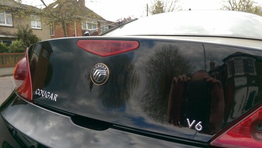

Lovely day here on the south coast so I decided to give her a good clean, always find it strangely comforting rubbing a cloth over the boob shaped domes on the headlights......think I need to get out more :(
I agree :LOL:
