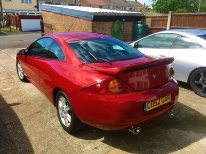

Coat of wax all over ready for tomorrow and plugged forscan in to see what it does - I think it may be too advanced for me!
I did manage to clear the fault codes and the code log, think I will have to read up on what else it does
