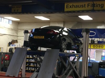

I took the C2 for 4 wheel alignment today.
It it had been in disgrace after failing it's MOT in September for offside suspension arm ball joint and shock absorber. We knew this time was coming as the front was still on original parts. So after replacing the wishbones, shocks, springs and top mounts on both sides the Mot was passed. I sourced all the parts but handed them all to our mechanic friend to replace. I think I had the last 1012101 bolts in the country. He did threaten to set my car on fire as it gave him a bit of a challenge removing the old wishbones :stfu:
We are now ready for Coombe.

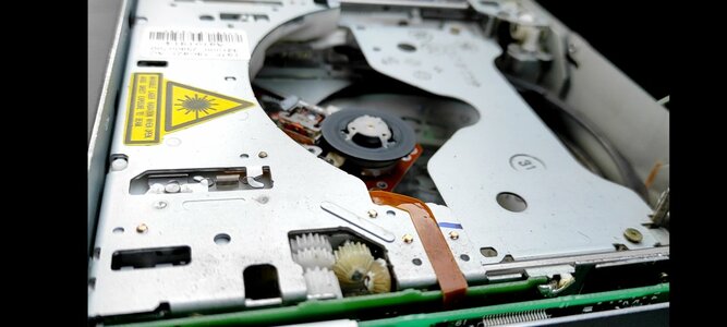

So then on to the radio; flat battery so was requesting security code. Also, only finding five of the six CDs I knew were in there.
Thought it would be quicker to use the decode app to get the code than find where I'd written it last time extracted the radio enough to read the label serial number, cables prevented it coming further. App ceased working (was a front-end to a webpage that had moved), know I've got one on Windows PC but kids here using that, so back to Google Play to try some others, a few pay-per-code, a few wait several hours, then a free one that gave an incorrect code, then another free one that had been downvoted on the store, but gave the correct code - that one stays installed and the code recorded in my digital notes app. Also found a website that instantly returns the same code - https://www.freefordradiocodes.com/
The power connector had come out of the radio when I pulled it forward - it was caught around the back of the lower slide bracket, had to totally disconnect the radio to free the cable loom before reconnecting. Radio was a replacement on/after 2005 - still a Cougar 6006E.
Then to eject the five CDs - wouldn't eject the sixth as it wasn't recognised, slot as if empty. Tried inverting the radio (hadn't put it back since reading the serial label) but resorted to taking the top off (two small torx on the back - easy) then after jiggling the disc it was recognised and allowed to eject normally.
Tested, watched and recorded the action of the changer, reloaded the six discs and refitted the top and back into the console.
Reset the dash clock, started and ran the engine, tools/charger away and in.
I think the cause of the flat battery was an MP3/bluetooth transmitter in the 12v socket - the socket being live the device had recently started coming on spontaneously rather than only when invoked, so that's been disconnected.

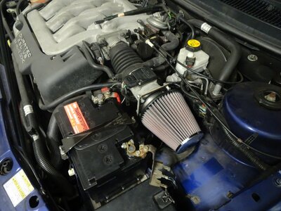

Finally installed the K&N air intake that was laying around since forever. Not necessarily to increase performance but that V6 sounds a lot meaner now :cool:
However, I begin to fear that long-time storage doesn't do the car any good. After having to replace the fuel pump beginning of the year, I have the feeling that the IMRC might have given up - was missing that extra boost after ~4000RPM when driving this weekend. Oh well, one additional to-do to add to the list...
