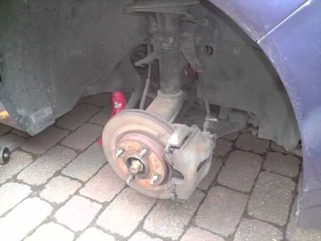

Had a visit from Tony and Alan today to fit my new wishbones with me. My car has been suffering from very bad rattles for the last couple of weeks and I had to take it off the road while I ordered the new parts.

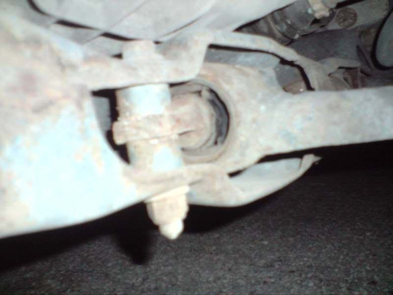

Old wishbone bush :yikes::yikes:

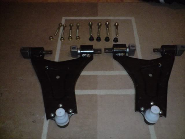

All new and shiney

Removing the damaged wishbone
