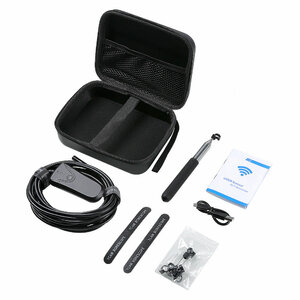

I eventually found a WiFi connected unit, so I could use iPhone or iPad as the display with a 5 Metre fibre optic and full 1920 x 1080p colour resolution for £13.50 and ordered it :-
This seems to have all the standard accessories, plus some advantages over competitive units. The idea of keeping display and probe separate also appealed to me. Doesn't grease and oil just get into every darned thing ?!
Here is their spec. :-

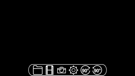

When using a unit without a built in display, it is likely that there will be some sort of software involved. True, it could just be a camera, but a lot of functionality could be lost that way. Clearly with an iPhone / iPad or Android there is likely to be an APP to download. I suggest looking at these before deciding as some are rubbish, whilst others may be simple looking but actually quite effective.

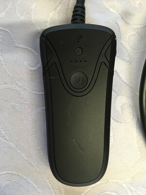

Above is Y-CAM's APP and the controls are all you need to have to deal with when you are already having to control the end of the probe. With the controls on the WiFi module at the end of the fibre optic and presumably containing the camera, there is On/Off, illuminating LED brightness and a camera button to take photos, plus a battery status indicator and micro USB charging port.

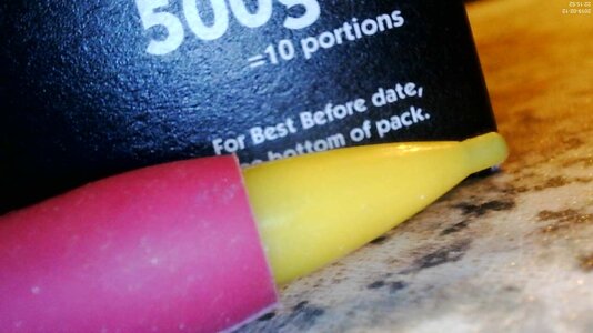

Here's a rather bad example photo :-
