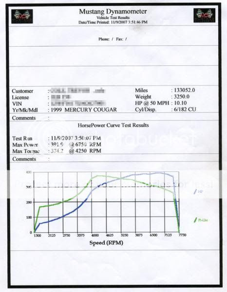

Preliminary dyno runs in 1999 Turbo 3L Mercury Cougar. The turbo is a Precision SC-61 and the turbo kit is home made using a TiAL 50mm BOV and TiAL 38mm wastegate and all 304SS tubing.

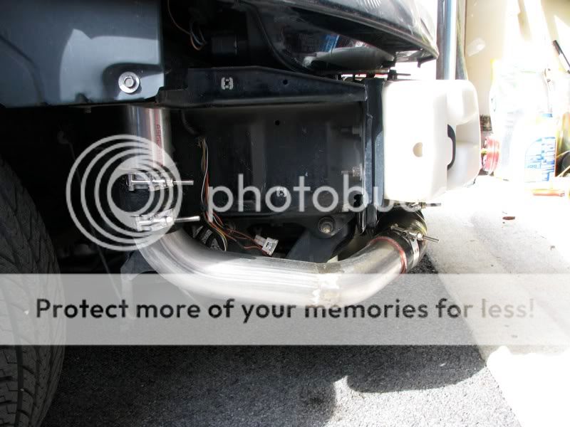

Most of what you see in the pics is the intercooler pipes. You can only guess at how fast that thing is, Paul's 2.5 supercharged car was said to be frighteningly quick.

Pauls car was silly quick!! Pulled away from me on the M1 whilst doing XXXmph like I was going in reverse!! Whilst the work on that 3L pictured is impressive, if I'd gone to that effort, if have at least got someone that can seam weld neatly to finish my pipework. Spoils it a little for my liking. Top job tho ;)

LOL.............I thought exactly the same thing kully, but didn't say anything cos I don't know enough about it, but the welding does let the whole thing down a bit, I agree.(y)

I liked it all except the turbo is a little too big for the engine and the quality of the job is let down by sawing a hole out of the front bumper bar so there's zero minor impact protection at the front end now. Someone bumping it in the car park will do chassis damage.
Steve, IMRC type stuff is only relevant on naturally aspirated cars. If it's forced inducted then the less in the way the better.
It's impressive work, but off the dragstrip I strongly suspect a slightly smaller turbo would greatly improve those curves posted up. As it is, that engine is pretty bogged down below 4000rpm. Good effort though! Wonder what compression ratio and pistons he's using. That's a lot of boost he's got on tap there!

It's an interesting way of doing it but the turbo over the top of the gearbox will cause hell with heat issues.

Almost 400hp through the front wheels?
I think that much power would only be good in a straight line, surely? A very little throttle needed or low revs for the corners.
