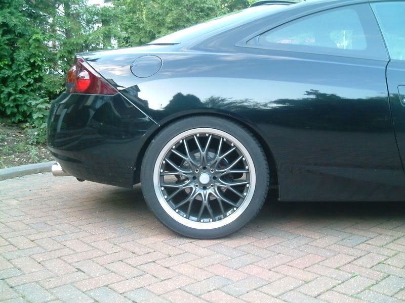

Here is what she looked like before....

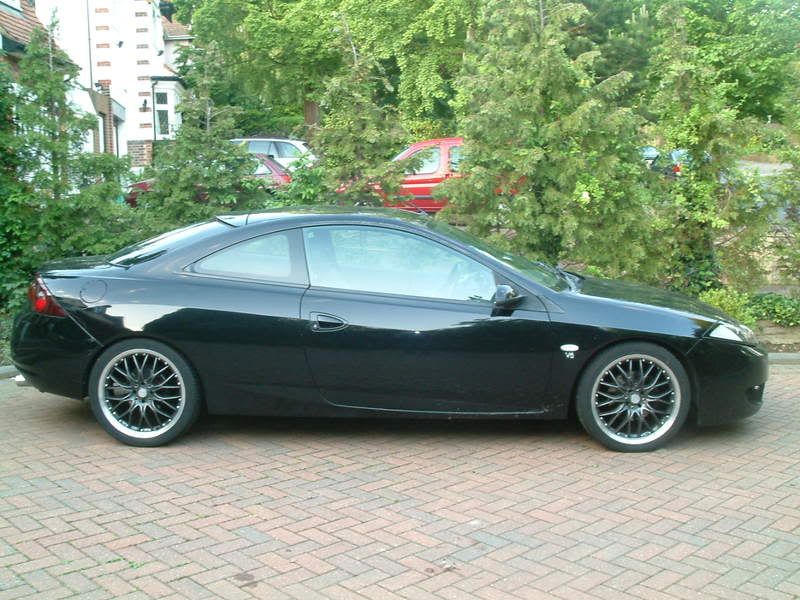

And here she is now 8)

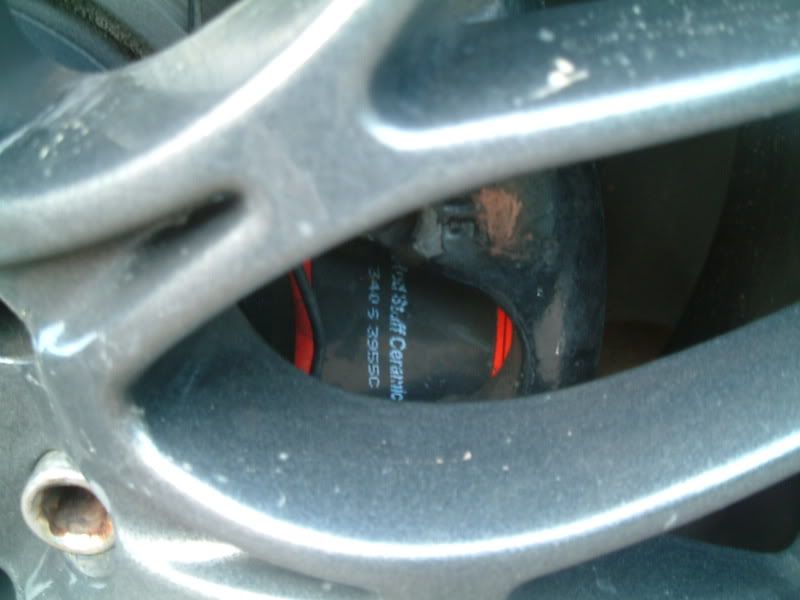

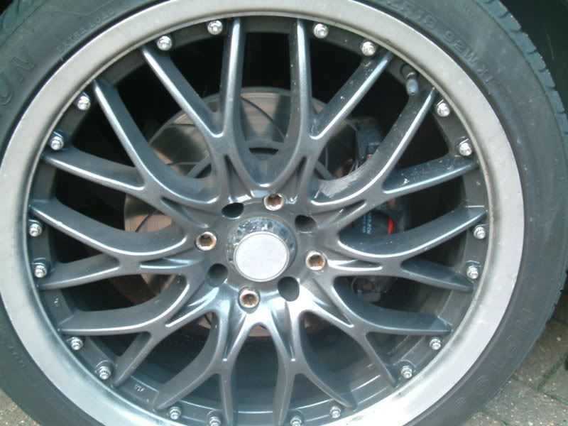

I also upgraded the brakes to Black diamond grooved discs and EBC redstuff pads :D Although after finishing the suspension I couldn't be bothered to do them myself so I took it to a garage and let them struggle with it :oops: :oops: :LOL: :LOL:
I am hugely pleased with the way she looks now, soo much better! The stance is spot on and the brakes look superb 8) Next I will paint the calipers red to match the pads :D
The car handles 100x better aswell, its unbelievable the difference the springs have made. It corners so much flatter and the understeer has reduced hugely, the dive under breaking almost doesn't exist now which makes the car much easier to control when you have forgot how tight a corner is :LOL: :oops:
The ride is pretty harsh now though, you want to watch out for potholes :LOL: But it still damps pretty well and is not as hard as I was expecting. I have to virtually stop for most speed bumps now though, the front bumper doesn't give much clearence, but I'll get used to that. I have got over some huge ones without grounding by going very slowly so it should be alright. I have scraped some when I have gone abit too quick though :(
But all in all I think its a fantastic mod and would recommend it to anyone with aftermarket wheels. If you have standard bodywork ie. no kits or anything, you will clear all bumps without any problems :D
