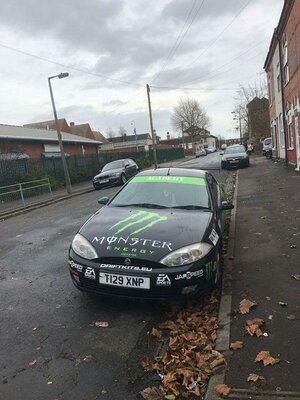

ls that local to us Ricky?
I havent seen that monstrosity driving about
Sandwell mate... he wants 550 for it... little over priced for me with nearly 150k on... i want going to have a little 2ltr project

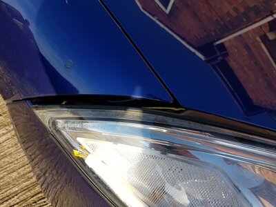

I do however still need to make the C2 lights fit properly
:lol: gotta love monster decals seems really popular but i prefer it a little bit more discrete lmfao
I thought I was reading a Backseateducation post there for a minute. But then I remembered that he doesn't do subtle at all!
I wouldn't drive the lairy thing, but to be honest the only thing that bothers me is the Japspeed decals. It's like fitting a Type-R badge to a Focus.
Where are you struggling, mate? They fit just fine if you ream out the retaining lug holes in the wings, though as Steve rightly says, there will always be a slight overhang at the extreme edge of the bumper.

£550 seems a fair price...I mean just look at all those....stickers

To be honest, I dont think i have cut away enough, this is how my headlights dont line up, i can only thing I need to hack more steel away
Deffo need to take more of the lip off, that's what I did and they fit fine now, try using a dremmel type tool, or even a grinder using a grinding disc, not a cutting disc, just do it bit by bit, check the fit of the light and when you are happy with the fit, job done..:thumbsup:
