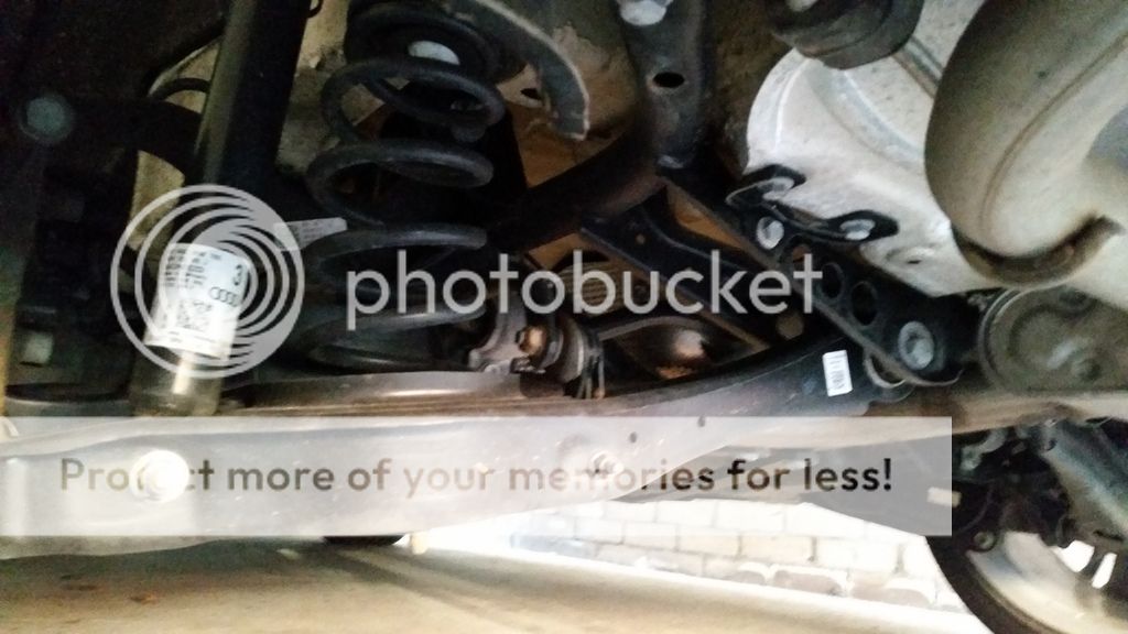

And on the free health check they found a broken spring near side rear, which they reckon has only recently gone (bugger)

New rear springs fitted (pair)- £670
