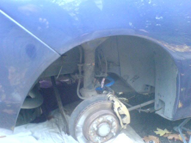

I'll let Alan give you the gorry details I'll just provide some pics 1st.
Oh Dear Alan has to do some "Hard" graft as he's forgot to pre-soak his nuts :?
Out with the old in with the New only 1/4 of the way there then :roll:

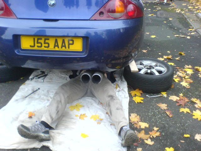

Stewarts got excited he's got twin pipes :wink:
Oh dear thats another Beer & curry for alan to pay for Stewarts getting very dirty!

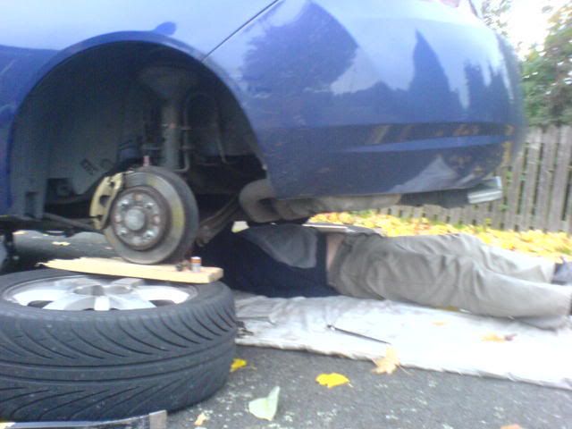

Almost finnished looks like Alan might actually be able to go home tonight......we think.......note Stewarts improvised use of a Crowbar!
