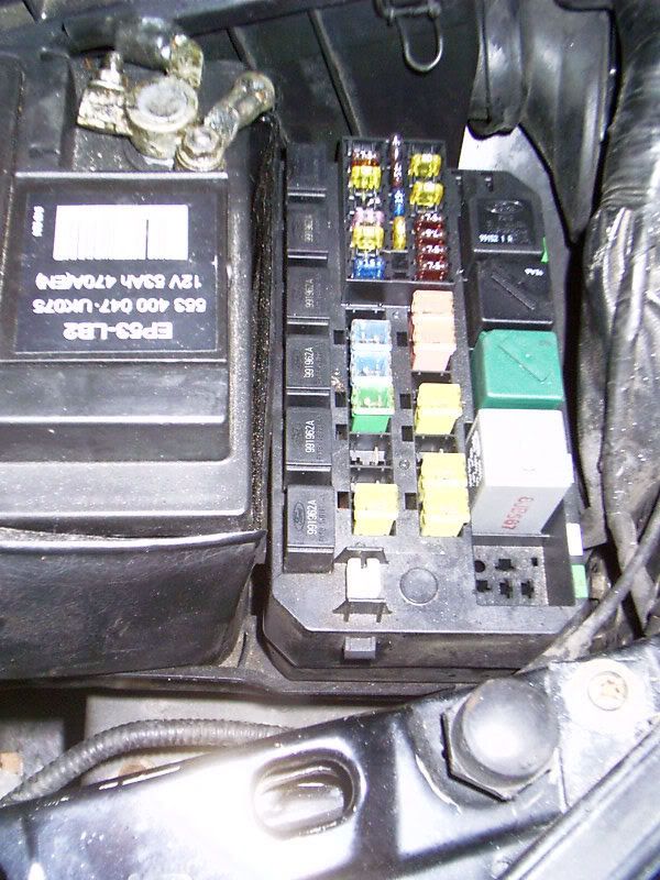

I could do with a new one, used mine the other day and apart from a 4" part in the middle nothing much else happened, and I checked the fuses the other day (when I was fixing my side light) anyone know where you get the fuses from as they are a weird shape (pink and square)

Engine bay fuse box. If you have the earlier 'squarer' fuse box its fuses 5 & 6 30amp green and a grey relay R4.
If you have the later, rectangular fuse box:
its the two pink ones in the middle(near the green and black relays) and the grey relay at bottom right.
As long as the 4" working part covers both halves of the screen (in the middle you should see a slightly larger gap between the elements - thats the split between the two sections) your fuses are ok. It's the elements that are dying - time for a new screen.
