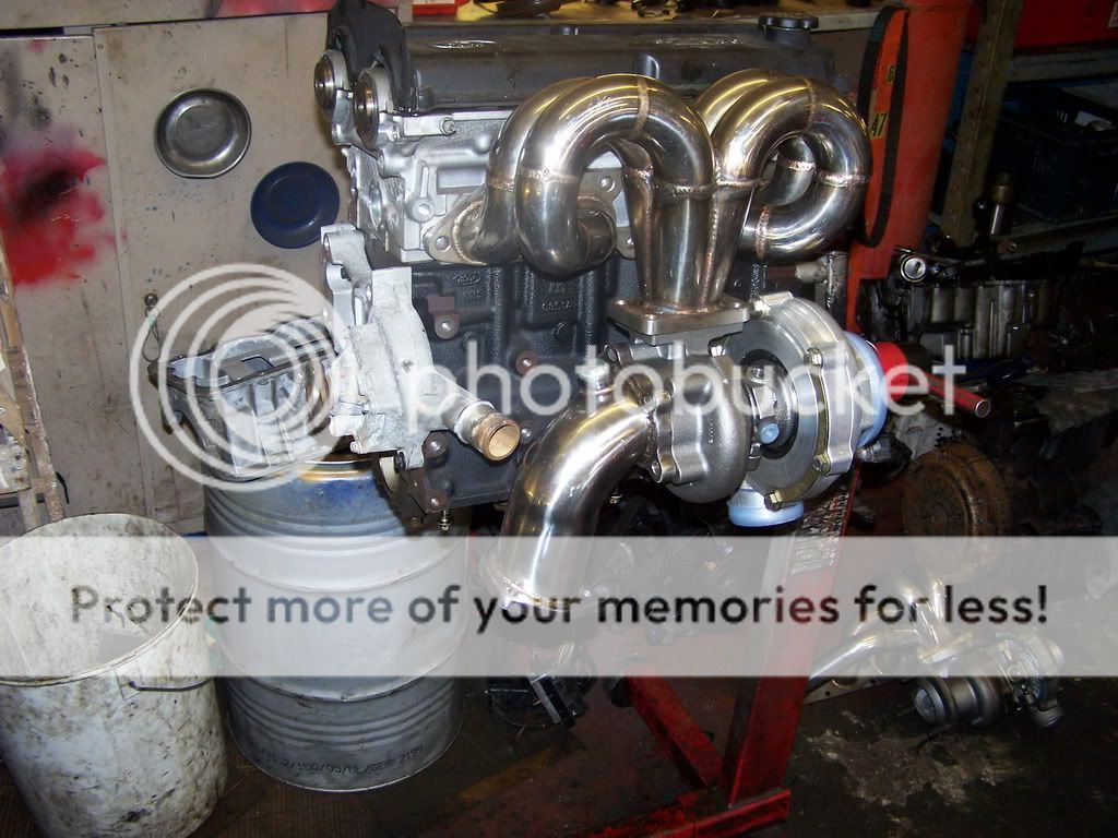

Set of forged pistons, circa £550, megasquirt say £300 + whatever to Map it, £140 for Injectors.
Then about £350 for ods'n'sods. I already have the T28 Turbo brand spanking new never been used. As for the manifold im just keeping my eyes peel'd for another Focus RS one to pop up on ebay, Like a tool i forgot to put in a bid the other night :\. I've got 3 boxes full of 2.5" Ally Pipe and Silicone Joints, Plus a pretty decent FMIC i should be able to get the first stages well under way for under a grand.
As for the 4x4 Conversion... If the donor mondeo's were even in existance anymore then it may have been a possibility, But i would never pay £1,000 + for a donor car, Not in a million years! lol.
I paid £265 for the fourby mondeo with multipoint gas conversion which i sold on for £300
Something like this you mean on the manifold front
This is off the 200sx been slightly modified and cost half the price of the focus ones.
