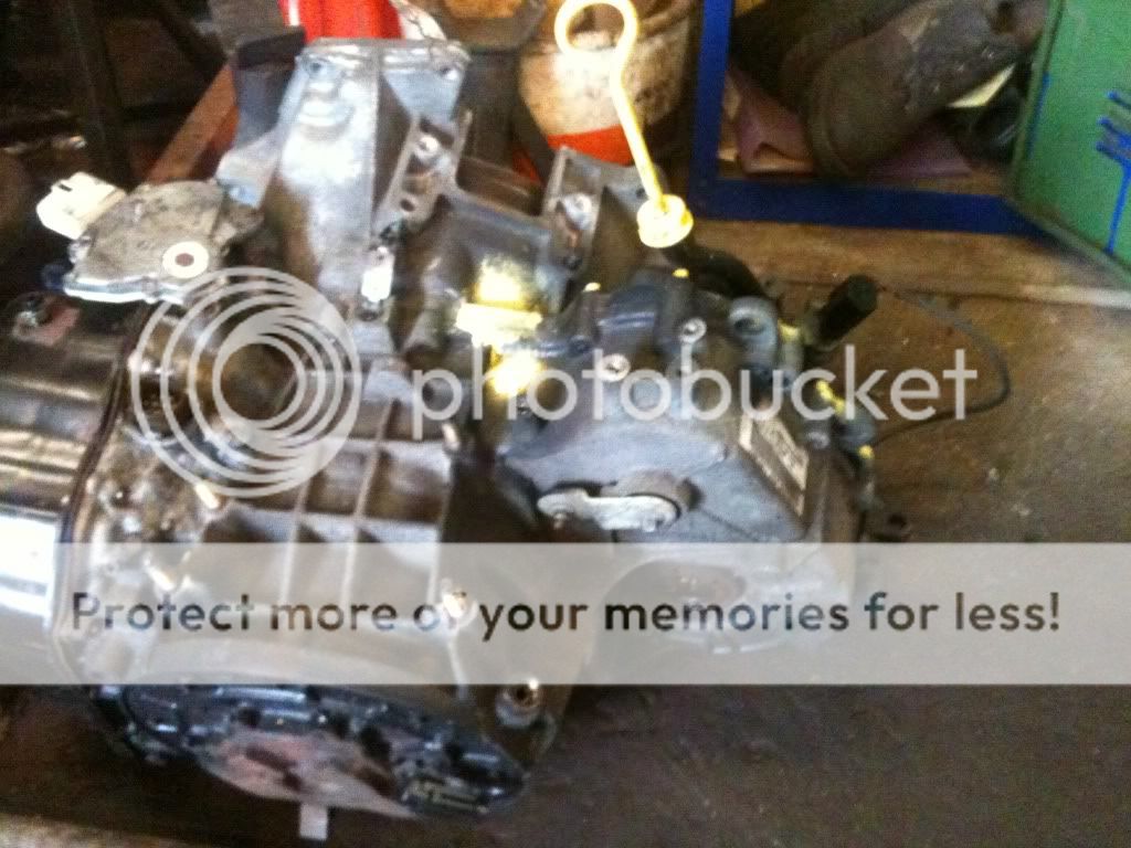

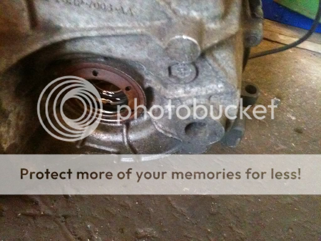

Pi'c, this is the gearbox he has to replace his with, Notice the point where his speed sensor goes is blanked off..

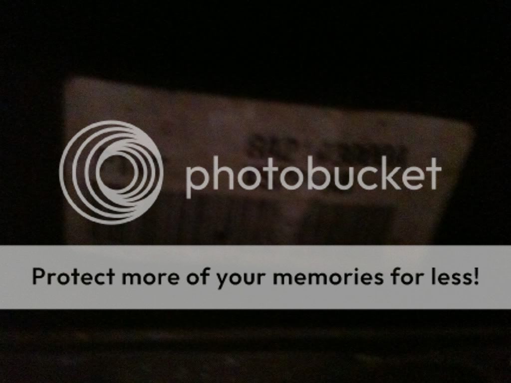

And part number..

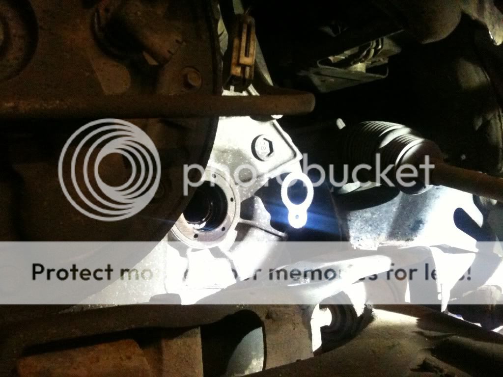

Now this is the gearbox on his car originally, notice that the speed sensor is in the place that's blanked off on the one he has just got to replace this box ..
With sensor fitted..

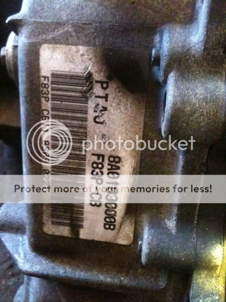

Part number of the one fitted to the car originally..
Right what we need to know is, what type is already fitted to his car?? and is there a way we can fit the one he got to replace it working around the differences??
