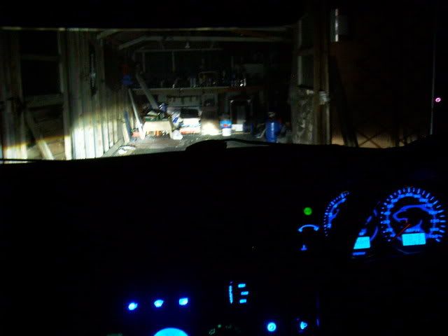

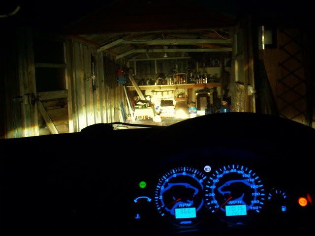

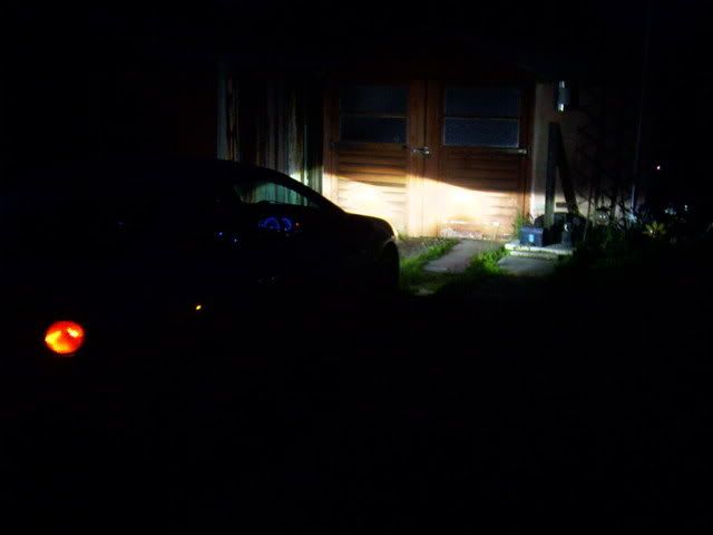

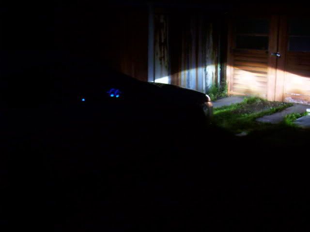

Some piccies:

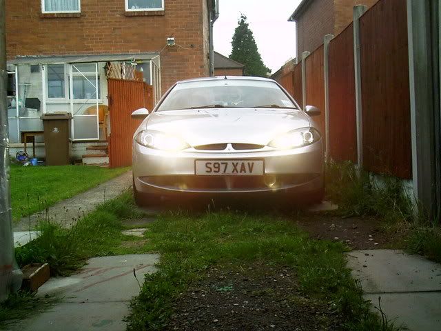

The first thing i noticed is just how much whiter these are than the standard bulbs.The photo's don't really do justice.
Notice the MPG? :LOL:(y)

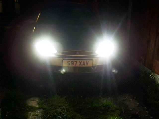

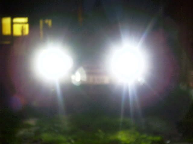

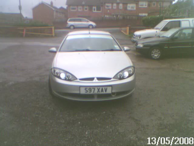

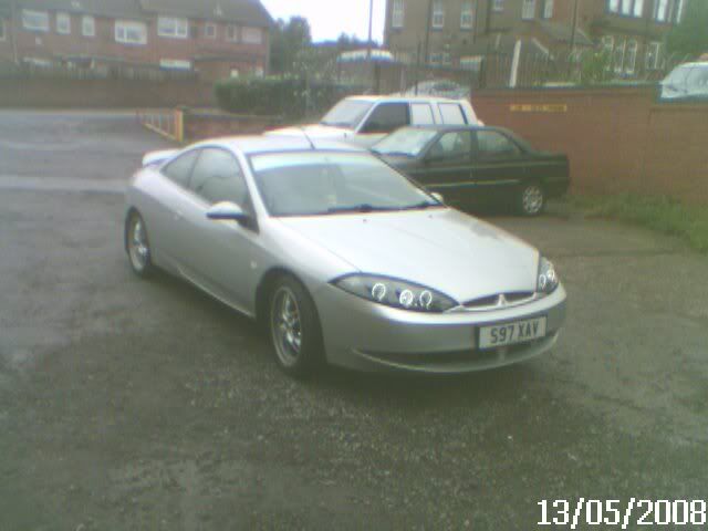

A couple of mobile piccies i took while waiting to get the beam checked:
The Red car in the corner is a brush painted scrap Triumph TR7.

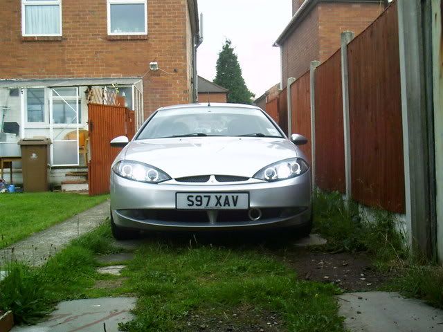

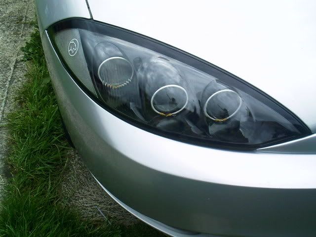

The new lenses are much clearer than my previous ones:
And you must have noticed! :smile5:

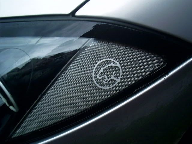

While the unit was open, i decided i had found a use for a couple of spare cougar head logo's. :wink5:
