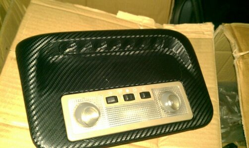

Latest trial....cutting the circles accurately for the warning lights stumped me a touch though
No. Get a punch the same diameter as the hole. The punch has a razor edge, so you use a screwing actionto cut through. Either that or use a modelling knife to cut into segments, 4 cuts should be plenty, then push the tip of your little finger through the hole
taking the vinyl through, then fold the segments at the back of the panel.
Done the spotty rubbers and very happy with the results.
Also, pictured the comparison between the real carbon fibre winglets and the vinyl strips.
Thought I would have a dabble with the old vinyl wrapping.
Far from perfect and a simple piece to experiment on, but I will be spending some time tomorrow on a couple of other bits.
I little more to it Tim, but that's the general jist
i have made a few mistakes, but its all an experiment at the mo
