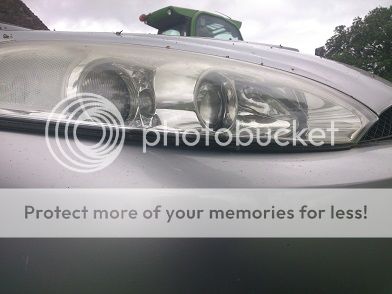

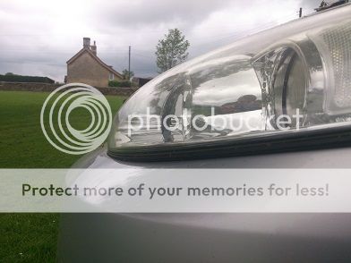

I can see clearly now......
The running lamps fit behind the triangular reflector on the wing end of the lamp unit and match the ones in the US rear-lamp units. They are plugged with a twist-fit grey bung on European C2 units.
So can you mod a C1 twist fit or has it got to be a C2 one to make it happen ?
Well I managed to get a set of bulb holders from an 02 plate Mondeo and they fit perfect. Maybe this headlight mod might happen faster than I planned now seen as it does look really easy to do and given how nice Andy's car looks with them on.
.......courtesy of Snowcat's old eyes.

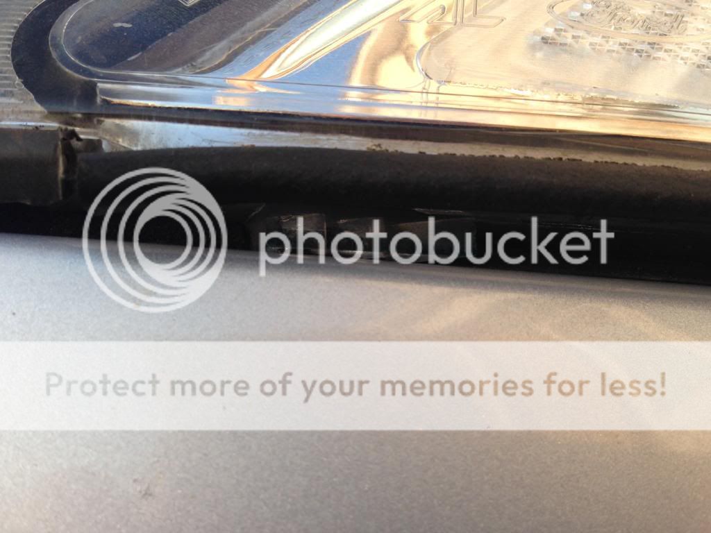

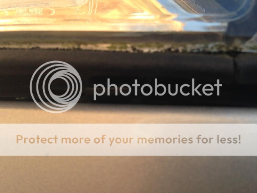

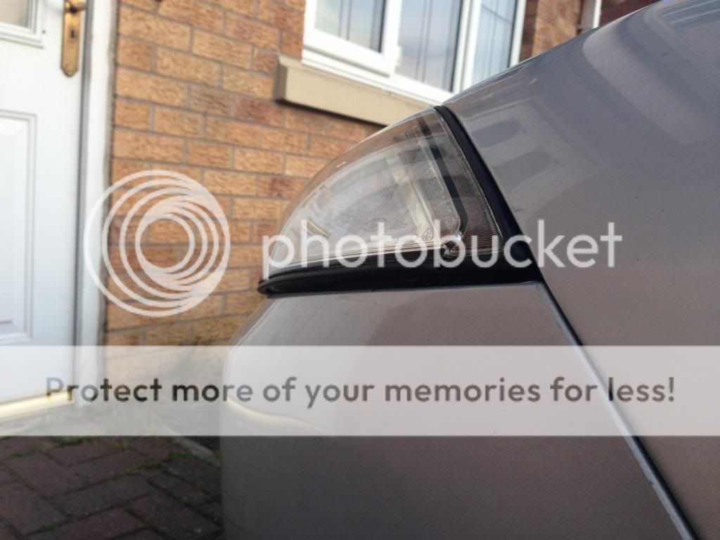

Does anyone have a close up pic of how their c2 lights fit to their c1's....i.e just see what sort of gap you are contending with v what i am?
thanks andy
think i may have some more to do.
The biggest barrier appears to be what can only be best described as a 'clip' on the under side of the light units.
This is the proudest part of the base of the light and causing me the concern as to trim the bumper for this to fit would mean me trimming almost to the bumper edge i think, while i don't think i can safely file away this clip safely? (see very right of this pic)
middle of this pic
left of this pic

Are you sure you have the light unit pushed all the way back into the wing? I've noticed that the C2 light does seem to catch better than the C1's. Try slackening the bottom holding screw and then give the unit a firm push back into the wing. Reason for this? Your headlight seems to have a gap at the light unit to wing joint.
