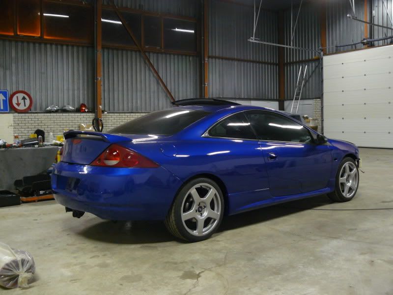

the car is on his wheels again :D
Looking good, that colour really does suit the Coug, I wonder why Ford never thought of using it on the Cougars???
