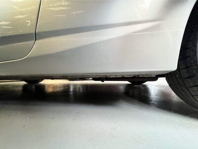

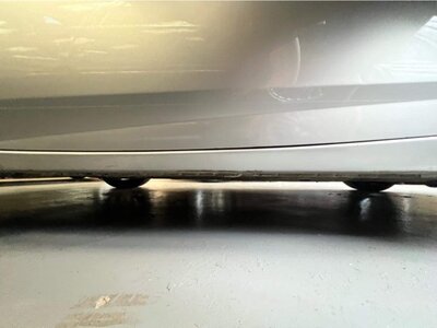

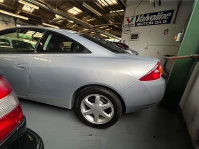

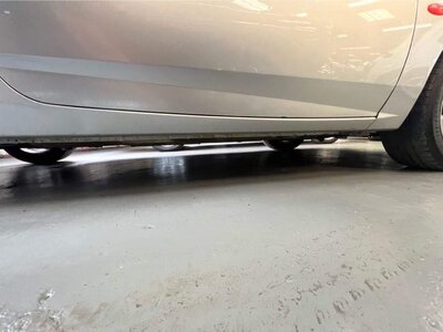

I’ve not looked at the video but studying the pics and zooming in I think there’s a strong possibility it’s had paint. Def rear wing near wheel arch, the under seal line is much less distinct on one’s identity compared to the other
Are the front wings a different shade ?, also the door shuts look messy, if it’s had paint it will have been a very budget blow over, the seller will know it’s not going to make big money so won’t have overspent on paint. One of the rear arches looks wavy at the top edge when zoomed in, filler maybe ?

Which arch would you say has filler? Now you’ve just said about the seal line I can see one is more pronounced than the other. But the side that I’d say has been painted which is the pass quarter has a thicker line, the drivers side colour looks good, under those lights it’s quite difficult to be sure.
Pictures can be very deceiving, on the video it looks like the passenger side rear arch is a different colour but could be a trick of the light, looking at MOT history the car was off the road from at least 2007 to 2019, how was it stored as rust could easy set in.

Mikey, it’s the rear drivers side, when you zoom in it looks like some rough edges to filler or paint that shouldn’t be there. Looks a bit like pixelation but the same arch on the other side doesn’t do it.

hmm it a difficult one really as i think they have led lighting in that building and this can make some odd looking shadows AND colours..40k is well low and id want to know why it hasnt been used...was it dry stored? or just parked up outside..if the latter it may have great mechs but bodywork will still suffer out in the damp/wet even if not used..
there is definatly a ridge shadow on that lower rear sill which is a tell tale sign of filler but then the seam looks like its been jacked up on underneath so could have caused that(NEVER JACK UP ON SILLS and if u see a tyre man try to do it hit him with a mallet and go elsewhere) :ROFLMAO:
as mabo has said u simply have to view it and do some knocking for filler and get a general feel for its condition...
