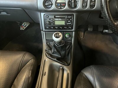

So, the auction house for the car I’m bidding on have sent me this picture. To me it looks like the fuse box is hanging down, is this normal? Should be be tucked up behind the glovebox?1B69CEBD-6A3C-4F2A-9C3A-DFBE488CB80B.jpeg
Associated Threads Merged.
Just to elaborate on the fuse box; it looks as though it has also come away from it's rear mounting points.
The two pegs, top and bottom, on the rear of the box (to the right of the photo) need to be located in their corresponding cups/slots and then the box should pivot upwards and latch in place. It can be a bit of a fight to get them to latch due to the wiring which has to be squashed as the box is swung upwards.
