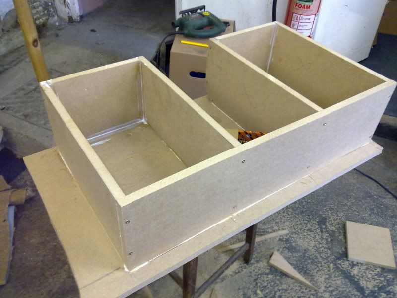

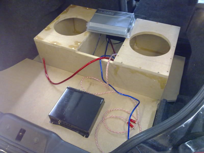

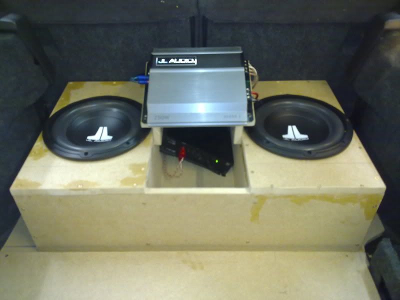

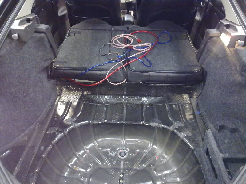

well took some pics today on the work in progress should be all in and trimmed tommrrow will upday pictures tommrrow just thought would show you guys the box build and all cables and will update with completed result
also will be split floor so i can get spare out
being installed are 2 jl audio w0v2 10 inch subs and 250.1 amp also jl audio

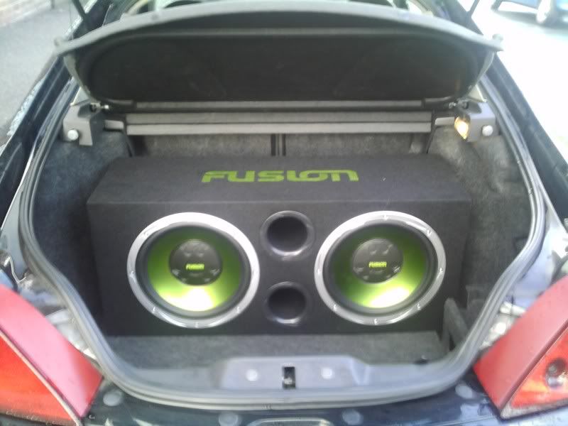

first pic is my old install

will be sealed was looking at band pass or a third sub but thought would be simple as its a bit of a demo car for my mates shop where stuff has come from and if anyone wanted same stuff installed can show them how it can be done for not alot of money

I wish mywiring looked that simple!, what glue has been used for the box or is it silicone?, if it is silicone mame sure it doesn't smell at all the fumes can perish the rubber/foam on the subs otherwise.

jl amp is running both subs and vibe amp will be tucked away out of site few more bits to do and yes perspex plinth will have a bend and cougar logo on it and led light at far end so will have nice glow and got few cover boards to cover up gaps on left and right should be all done by the weekend fingers crossed

just a quick update i am running subs in at moment and waiting for some trimming carpet to come as i will need a **** load to do it all then i will change the wiring on amps to get more power to them
