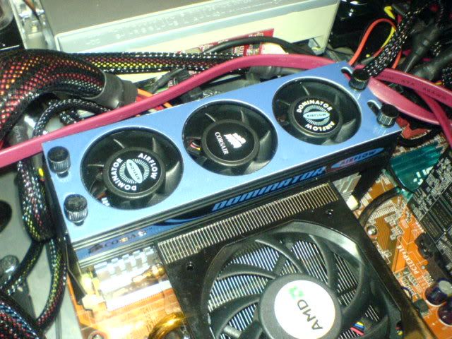

Oh the fan for the RAM came today looks great,fits over the top and has three 40mm fans built into it.
Its not going to be very quiet with all those fans....

They are all controled by the Motherboard BIOS mate, it has AMD's Cool & Quiet Technology only gonna be about 20db or so <max 30db> plus the two case fans and the PSU fan are "silent" ones (Case fans are controled by temperature sensors via the digital display)
I know some Pc's can be noisy, i've just reduced the fan noise on this one i'm typing on using speed reducing cables (mind you the last cable I got from Maplins was wired totaly wrong, + to Positive and - to positive too):skep: soon sorted that out, not exactly quiet but its ok to say it has 5 fans (if you include the 80mm CPU,80mm System, 40mm GPU and 2x 60mm on the rear)....plus i'm sure there is one in the PSU

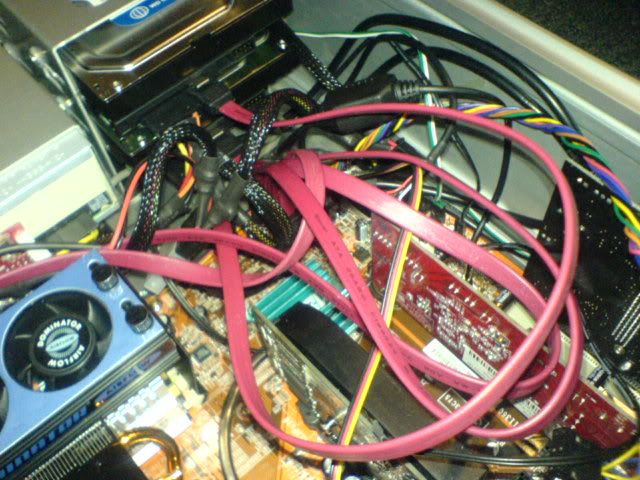

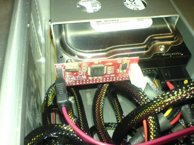

Anyway i was waiting for two IDE to SATA converters for one of my HDD's and the DVD-drive, only small little circuit boards but allow me to save space in the case by using SATA cable instead of old style flat IDE cable (I couldn't wire up the DVD & the HDD as the cable wouldn't fit in the space available)

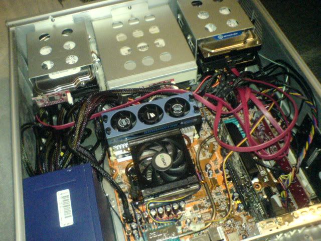

Nice bit of SATA Cable Spaghetti anyone ;)

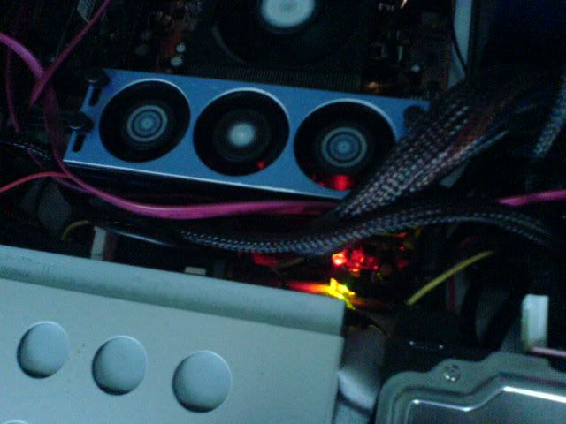

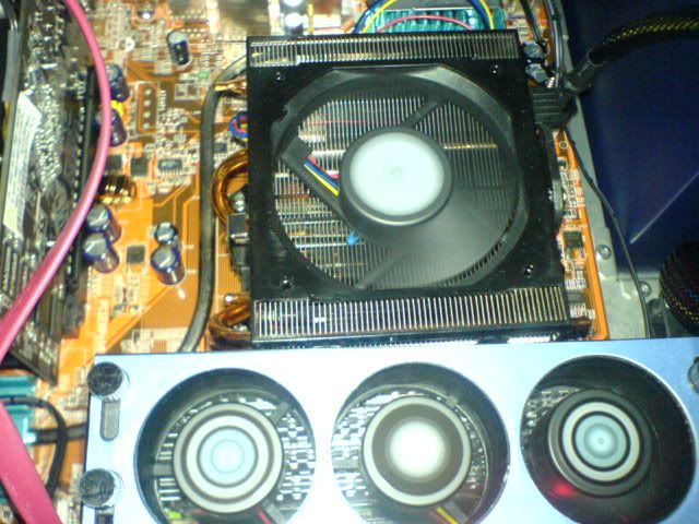

Still got the Drives connected then fitted the RAM cooler as stated earlier (quite a good looking bit of kit) to cool those RAM chips down when its running HOT! HOT! :ihih:
Although as you can see there is a lot of air space around the CPU (plus there will be another fan with a duct above the cooler)

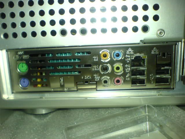

Just a couple of pics of the connections on the back: 4x USB2, Network, 7.1 Audio, Keyboard/Mouse & vent for North-bridge cooler.

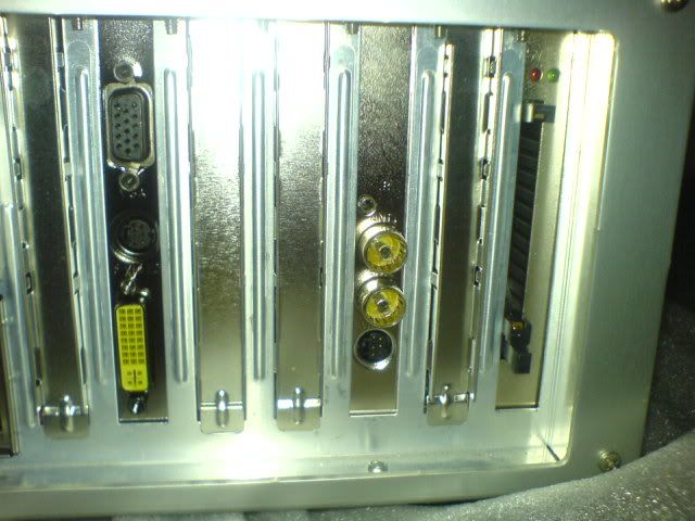

Graphics card, showing analogue and DVi sockets, Free-view card showing twin aerial sockets, and PC Card reader (for the Wi-Fi lap-top card)

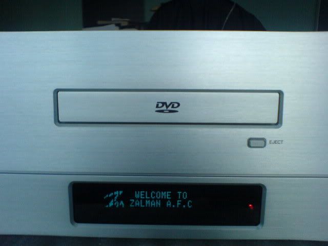

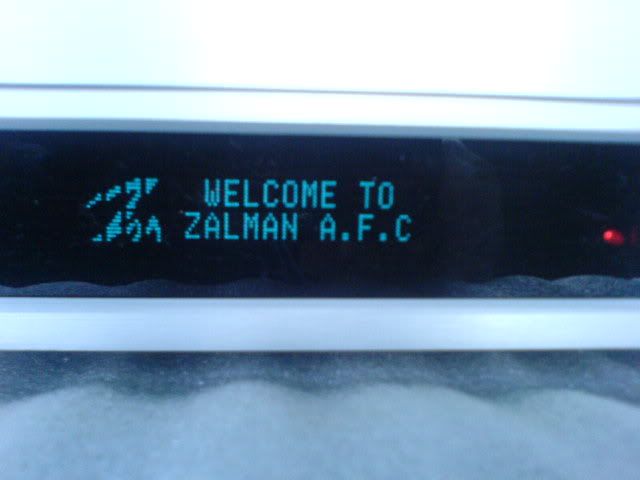

The digital display lights up also with a welcome message from the case manufacturer

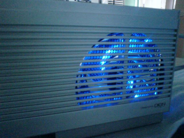

I'd forgoten that the PSU was also lit up with blue LED's

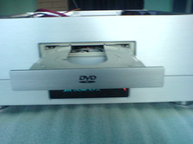

Next task was to fit the DVD-Drive bezel, a pretty easy task: You have to remove the outer drive units tray cover 1st (done before construction)
Then the new Aluminium Bezel simply sticks to the tray with sticky tape..
All in all very neat and tidy.
