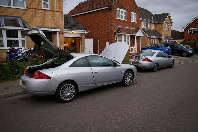

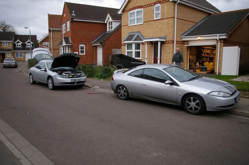

At long last, our C1 is now back on the road with a pair of new wishbones and front tyres.
Once again, Mo and I owe a huge thank you to Tony (cyrano1127) for his hard work today. Cheers Tony. :D :D :D
It's nice to drive in a straight line again. :LOL: :LOL:
Here's a few of the pics I took of the occasion.

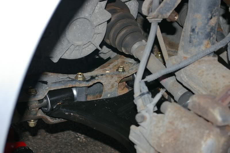

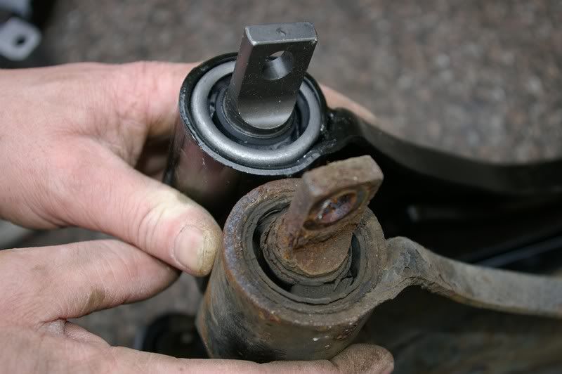

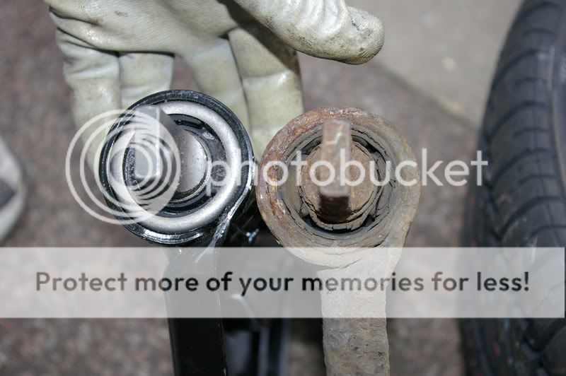

New wishbones

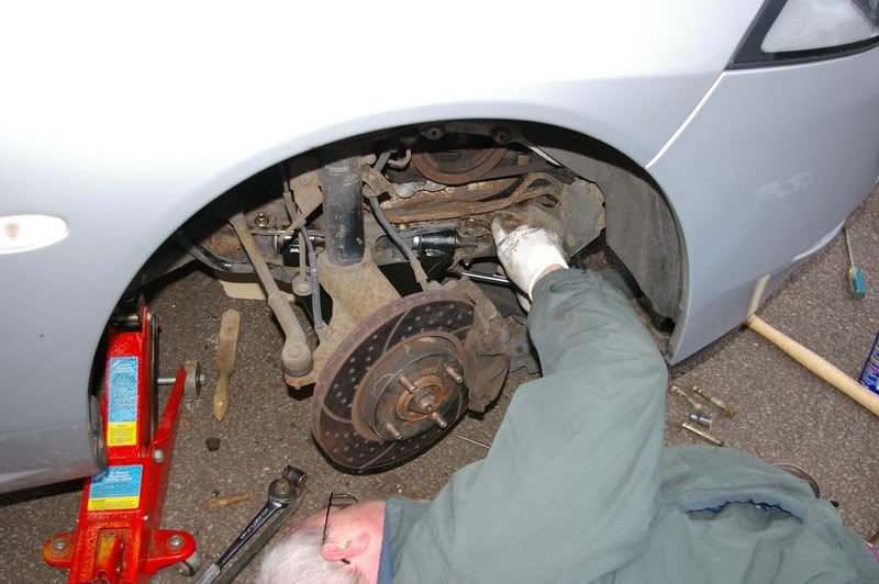

Driver's side.

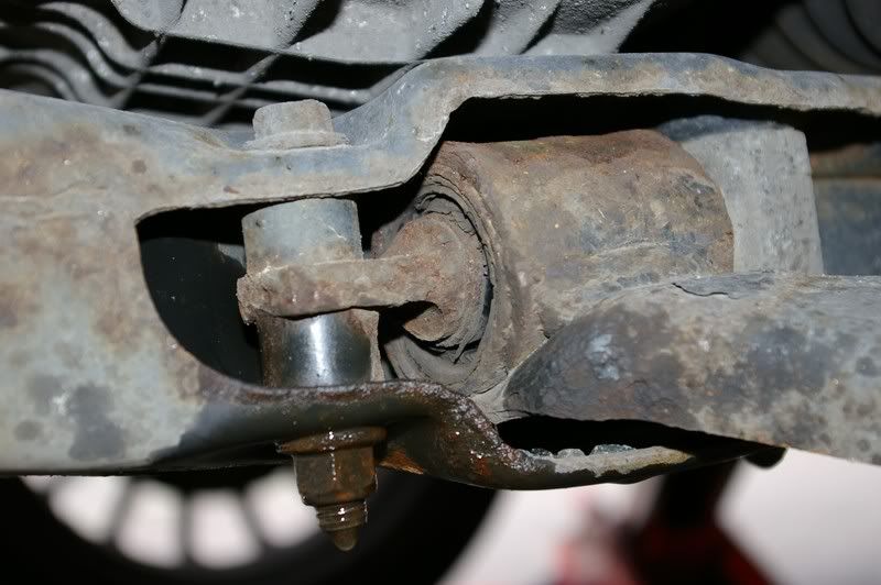

Tony did this side properly by lowering the subframe so the bolts could go in the correct way up.

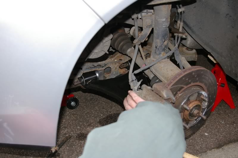

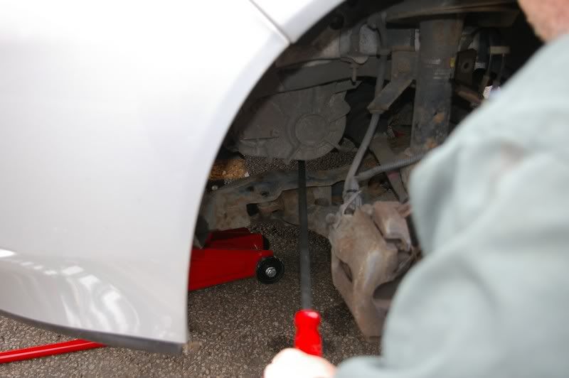

The subframe needed a little leverage :eek:

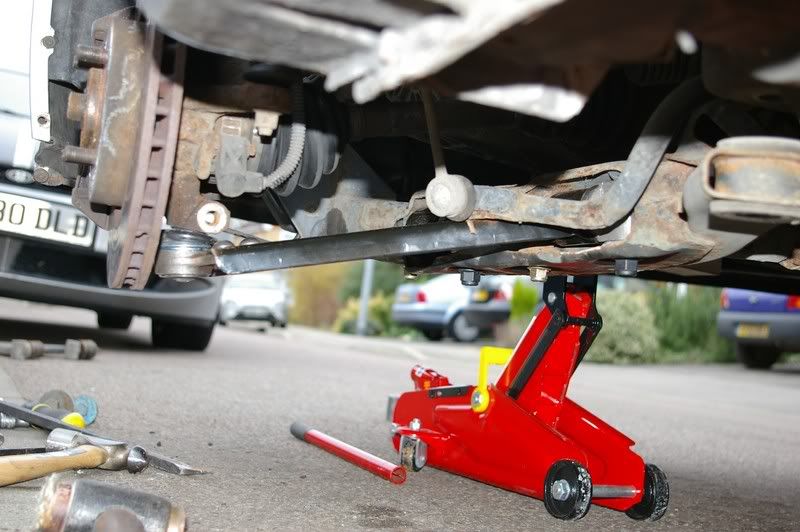

And now the passenger side.
Not many pics of this side as I popped out to get the tyres fitted.
Job done. :D :D :D
