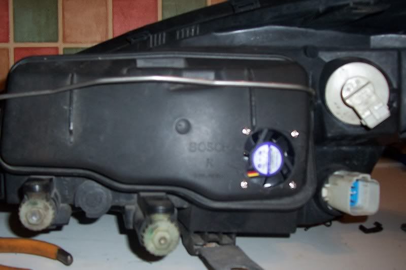

Don't drop the bonnet! :hand: Thats what breaks the tubes, and get some ventilation into the light units as Rob and myself did, or put the inverters on the outside of the headlight unit. :idea:
