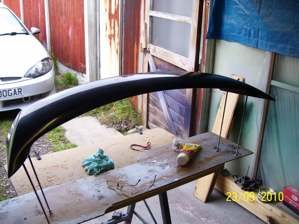

I've sprayed loads of frosty paint, done a bit of green, even odd bits of blue, but the Ebony is a rare paint for me to use, i've only ever done a few jobs with it, and this one in particular, a oem spoiler. I really enjoyed prepping and painting it, but i have especially enjoyed the finishing stages, the black gets better and deeper with each polish. I finished it by hand and found it to be very theraputic. Still bunged up with a cold so this was a pleasant distraction. The shine just doesn't show, but it is like black glass, or should that be EBONY GLASS :
Get some G3 on, this is after the de-nib stage flatting:

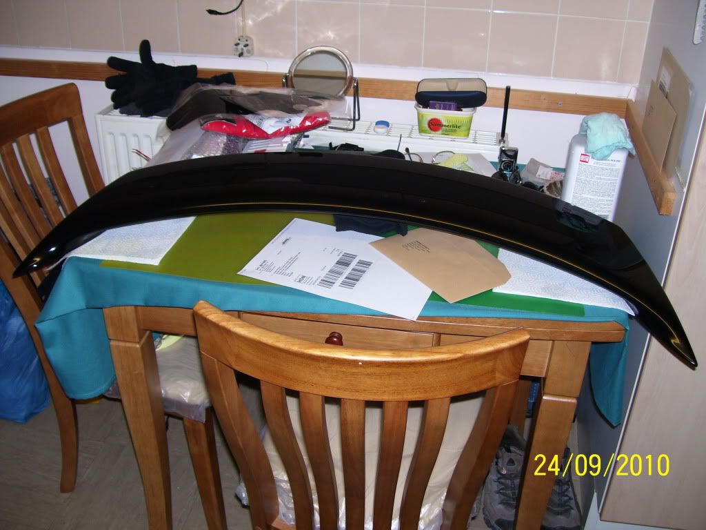

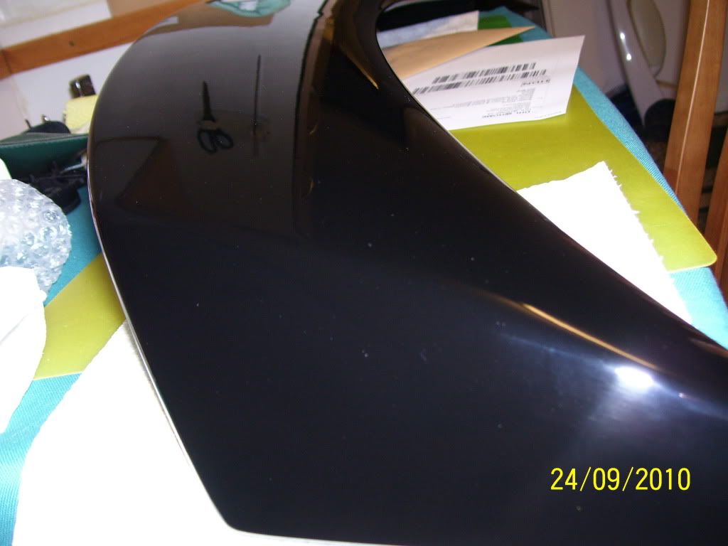

Try a bit of polish.
...and like i said, it just doesn't show.

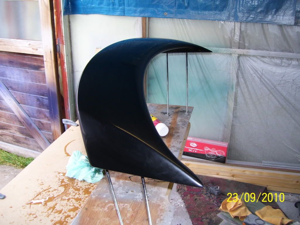

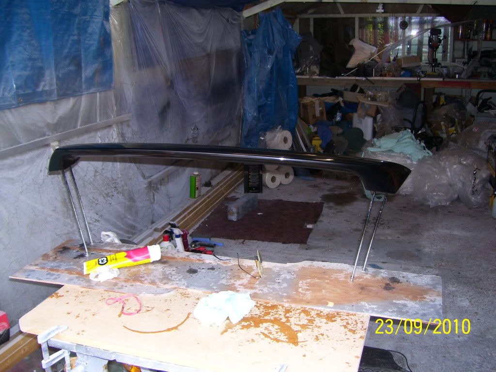

I see you made the spoiler rig Al perfect for the job in hand!
Yes, beleive it or not, that is the very first spoiler i've done, and realised it needed to be elevated for me to get underneath with the gun. A couple of lengths of 6mm threaded bar did the trick.
