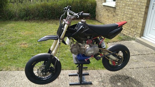

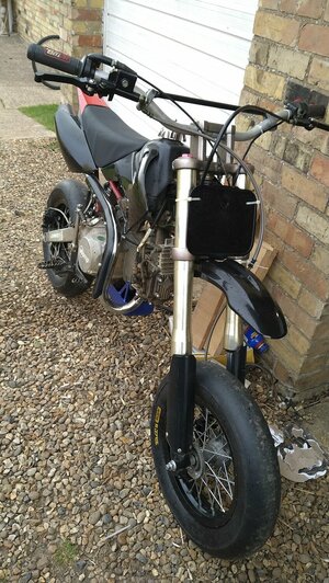

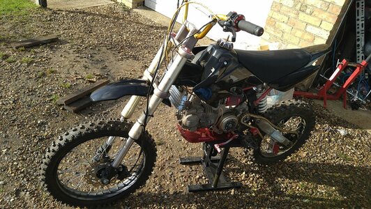

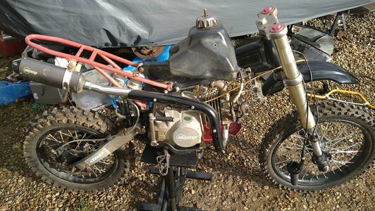

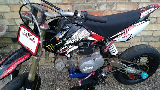

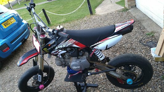

So anyways, new addition to the fleet, those who have FB have been watching this develop over the last few weeks or so lol but say hello to the Pit Bitch lol

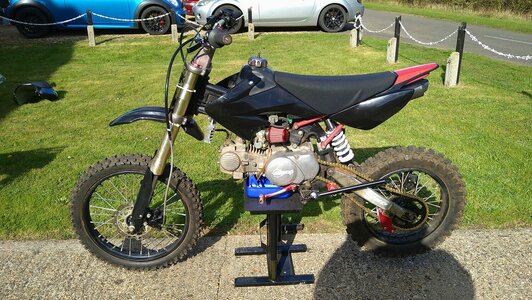

Started out as a 2009 Stomp 140 and after a few mods, additions, upgrades, swear words, wheels, more swear words, new bits and skateboard wheels (yes you did read right lol) it's pretty much now where it needs to be which is a supermoto pit bike, that's 140 of your finest chinesium cc's on 12" slicks with dodgy upgrade brakes, and very suspect suspension :ROFLMAO: that just makes you giggle endlessly every time it tries to kill you lol.
Stew and Michelle already have their own, i just need to see if it's possible to get hold of a Kane sized one :ROFLMAO::ROFLMAO::ROFLMAO:
Anyway heres some pics being as i can't edit post #1 lol

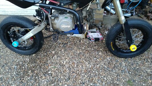

As it arrived, so this happened...
Which led to a few other things...
Which ended up as this
Oh yeah, and the skateboard wheels lol

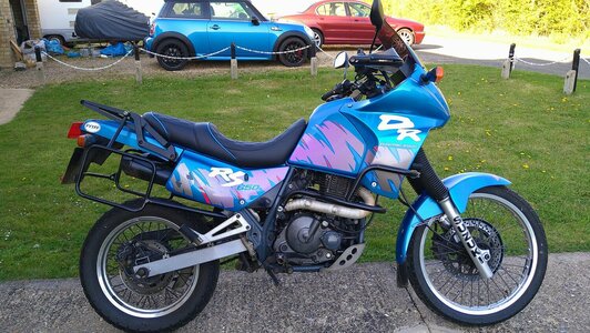

Loving those front forks, they’re mahoosive, way bigger than those on my Fazer thou 🤩
Wonderful DR too, fantastic colour scheme, my love of trail bikes started back in ‘81 when I bought my first bike, a Yamaha DT50 - oh the power 😄
I had a chickenchaser lol so i sort of gone full circle with the 140cc Honda inspired chinesium pit bitch lmfao

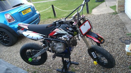

These things are great lol full sticker set for the Pit Bike for a tenner lol half an hours messing and it now looks like this yay
Fun little machine :cool: 😁

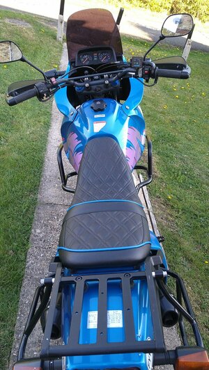

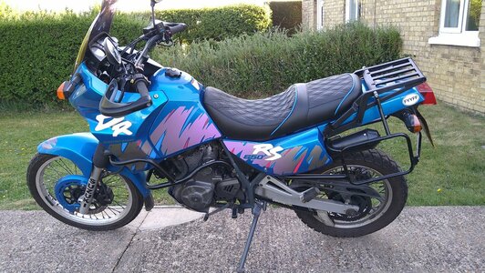

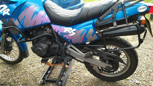

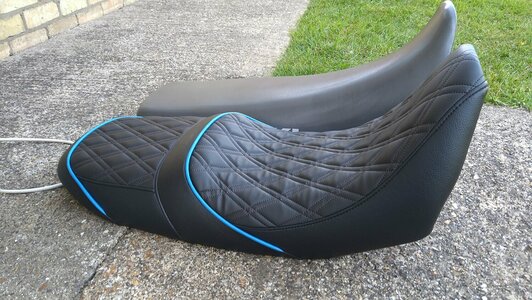

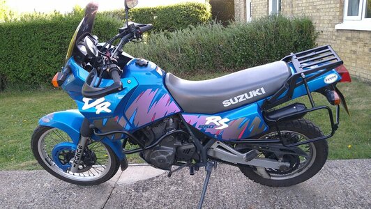

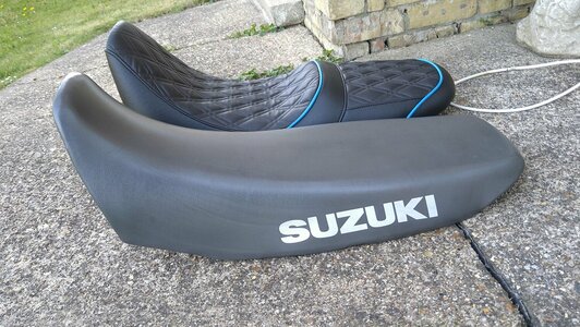

......I was messing about with the DRX, couple of things to sort, one of which was contacting Kev SDM to get his Dad to knock me a custom seat up, as the standard ones leave me with a numb backside after about 30 mins in the saddle.......
So after a bit of a chat, and showing Derek what I was after, we discussed replacing the cover and quite a bit of the 29 year old foam and vinyl lol, went to fetch it and was stunned not only with the quality, but also the price and what he'd actually come up with!!! So cheap and looks brilliant!!

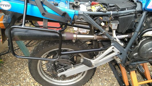

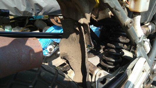

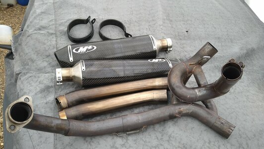

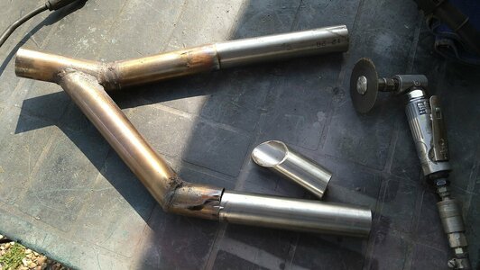

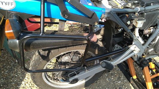

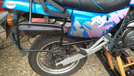

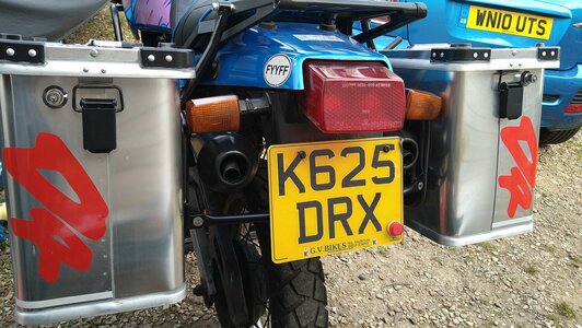

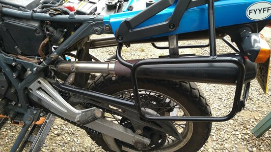

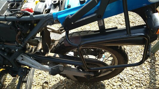

Also if you look at the last photo you'll see that the end of the mufflers finishes inside of the box support frame, this was causing some minor overheating of the box mount fittings and some discolouration of the ali on the box from the exhaust, so attacked with a grinder, cutter and welder and came up with a 4" extension to both exits on the Y pipe.........
Also as you can see above, i've added some aircraft grade crimped stainless sheet to hopefully keep some of the heat from the exhaust away from the bottom of the battery box.
Post automatically merged:

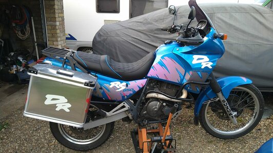

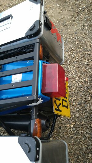

Also had some vinyl to add to the boxes as the frame had started to wear on the ali a bit
So now it's almost where I want it, some inspections and adjustments to the motor will be next followed by some paint on the bits i've just modified/made, Happy Days :cool:

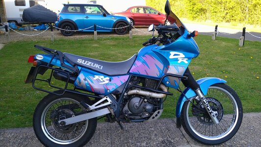

Loving the pit bike but the DR is absolutely wonderful 😍 You’ve got a cracking bike there and your mods are only making it better, I’ve now got ‘search alerts’ on eBay and Autotrader - just don’t tell the wife 😆
  • Haha
Reactions: TopCat1127
I know, everything from the 80’s thru to the late 90’s is so expensive now, far too many mid 40/50 year olds with cash in their pockets trying to revive their biking youth 😎

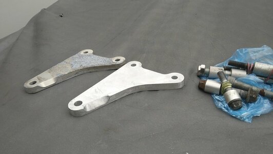

Made a new plate to reinforce the frame mounts for the TLR so i can do a rear shock conversion to Ohlins, which i picked up cheap a while ago, i've already had it serviced, and just need to repaint the spring and knock up some new bushes

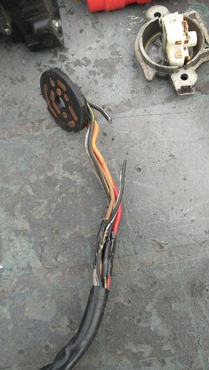

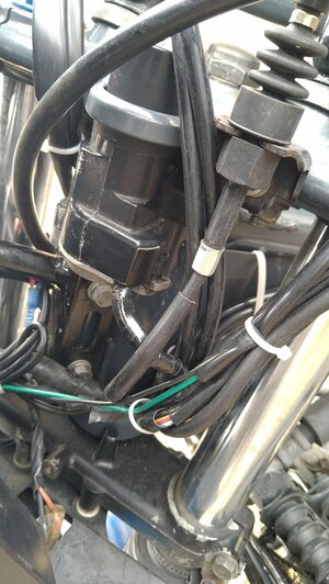

Had an issue with the DRX where it wouldn't turn off unless you hit the kill switch lol
Broken wire found in the back of the ignition barrell along with some previous owners wiring mods lol but soon sorted that......

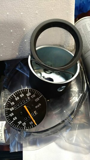

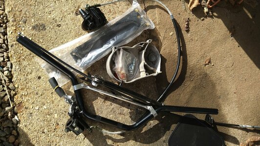

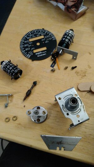

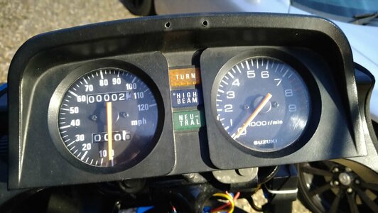

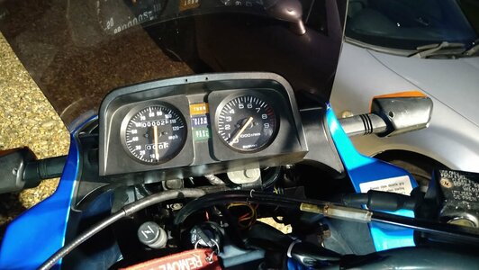

Also found a NOS speedo off a later model which comes in an ali case, already heard that the internals are the same so the old one which was pretty much shot....
And set about the brand new one with a screwdriver lol
And fitted the internals into the old binnacle, happy days

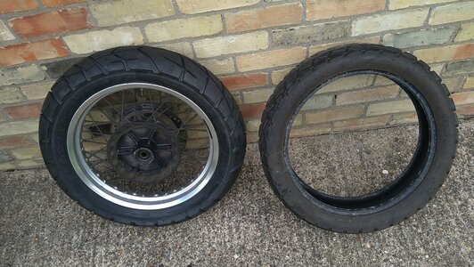

Oh yeah chucked a new rear tyre on it too, so no more souare corners for a while lol

The worst square tyre I’ve ridden was decades ago on my GL1100 gold wing. ( just before it went Aspencade )
Because it was so hidden I hadn’t noticed how bad it was.
I got to thinking it feels strange, so took a peep, literally square and slick on the flat, might explain why it was drifting in the wet ! Skinny tyre too by today’s standards.
