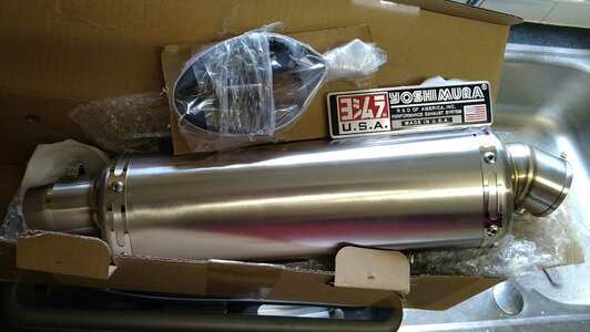

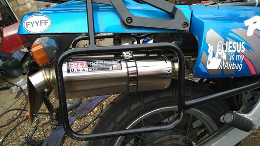

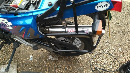

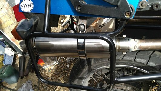

So did a thing today lol found these bonafide genuwine chinesium Yoshi cans on fleabay for £120 delivered lol, must be worth a punt i thought, i wasn't wrong lol, look the part and sound awesome with a bit of modification to the baffles 😁
Jobs a good un :cool:😉💪 sometimes chinesium comes up trumps lol

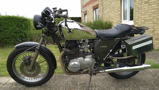

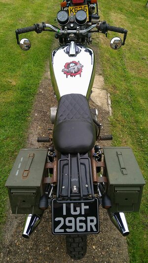

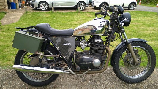

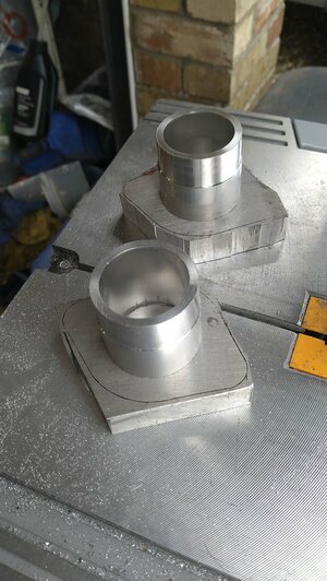

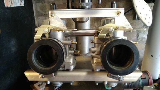

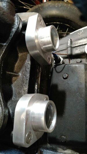

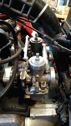

Well he may have saved that one but Kate the Kawasaki has had my attention recently lol bought a pair of Mikuni's off a mate (nice n nearly new ones) so set about making some adaptors to fit the Kwak and also linking the carbs together, with single sided choke operation and a new throttle cable (which still needs finishing) looking good tho
She looks good TC. Back as an apprentice a mate had a Kwak 400 and I was on my 250N Superdream. So I recognise the Honda filler cap. We used to do day trips around N Wales with girlfriends on Pillion.
Paint next ?
Reactions: TopCat1127
Tank is off a CX500c so good spot, still got a few finishing touches, as well as some electrical upgrades, but yes, full strip and repaint is deffo on the cards at some point, altho the head gasket has reminded me that this little thing is 47 years old lol
CX 500 Custom as you well know. That was my suspicion.

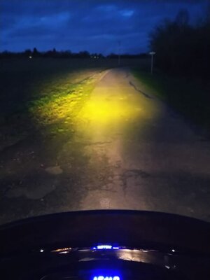

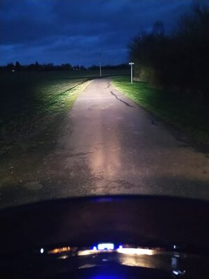

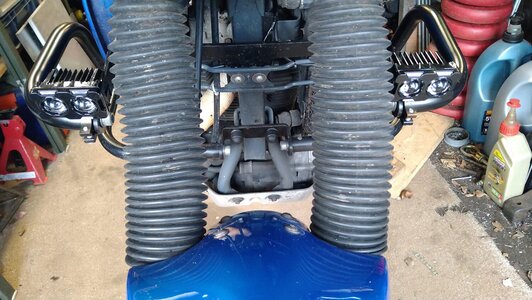

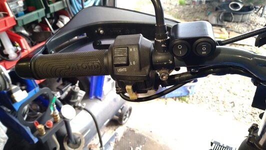

This week has also been about sorting out some decent floodlights for DRX, i'm on set 4 now lol thanks to cheapo listings that don't explain that the lamps have to be cycled through various stages every time they are switched on!!!
But these ones don't, theres on and on lol yellow light for fogs, white light for floods, flippin brilliant, even found a double switch to mount on the bars, finally got them all fitted and working today and am well happy
New lights mounted on the crash bars
New switch unit (wanted 2 singles but they sent single and double.......still ongoing lol)
High beam with fog LED's
High beam with Flood LED's, loads better :cool:

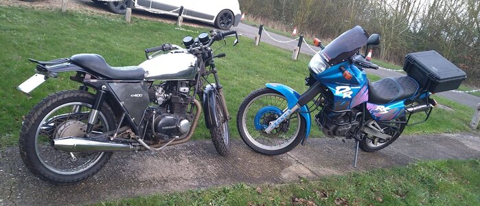

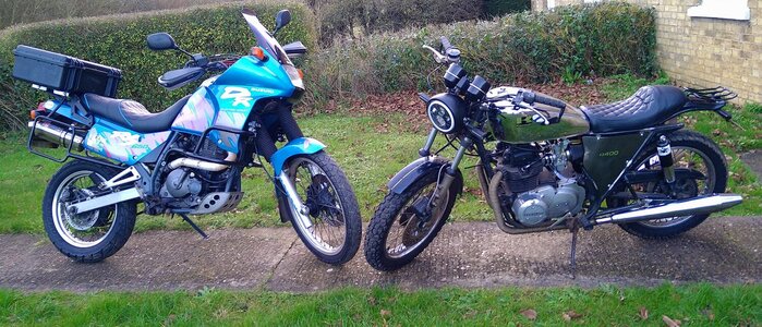

Now i have 2 working bikes lol

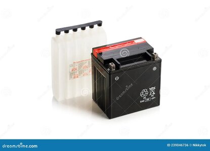

Interesting stuff Tony. Some time ago I invested in a Silverline Battery Load Tester that would be useful to demonstrate the lack of current. It wouldn't however, help to get the message across to ignorant non believers !
I may have mentioned that for many years, I looked after IT for a large motorcycle shop in Norwich. Chris Ball of CJ Ball Motorcycles was in my class at school ( along with my wife, his 2nd hand bike sales manager and a woman who would later become a dame after running HMRC for several years, but that's another story ).
Anyway, I am always curious about things and have notced when I see new 'wet' bike batteries, that they tend to come as a kit in a box. This has a dry, empty battery and a plastic gizmo with a set of tubes for individual cells, containing the acid. It seems that to avoid spillage and conform with international transport laws, that it is done this way. At point of sale, well probably at point of stock control, somebody takes the battery out of the box, removes the top and fits the gizmo in place to deliver exactly the right amount of that acid into the cells. So adding your crop of zombie idiots to the situation makes me think that is where things are going wrong. The cells don't get the right amount as they are ham fisted, and that sets the scene for the battery's lifetime. After that they get charged for the first time, before sale. Imagine a shelf of these in the stores.
I struggled at first to find a photo, as most seemed to come with a single electroltye bottle, which would be even more likely for them to get wrong ! But I then came across what I have seen many times. Here's a pic :-
