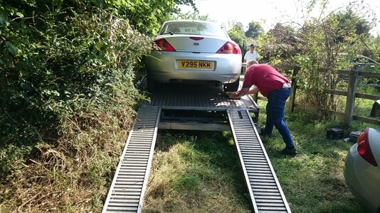

Everything went seamlessly yesterday and we didn't even have to resort to chiselling the lockers off, although Kevin did do one of them before i suggested trying to actually move the car before dismantling the brakes : ie, try the door before you kick it in :).

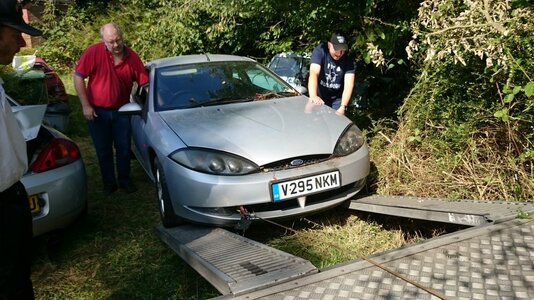

Winch hooked up and there she went, rolling free so no brakes hassle. All ready for Charlie and Anne to collect today.

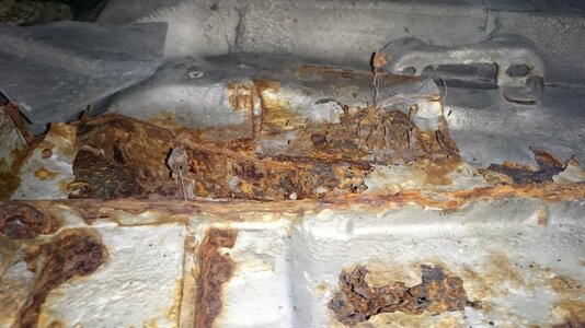

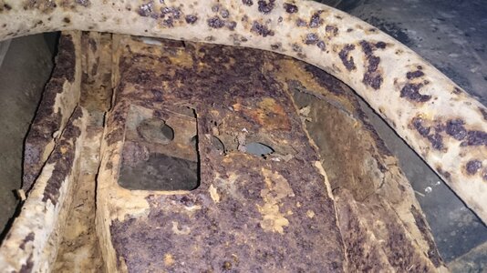

Rear subby won't float, too many holes in it.

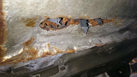

Both front sills holed, drivers side really badly.

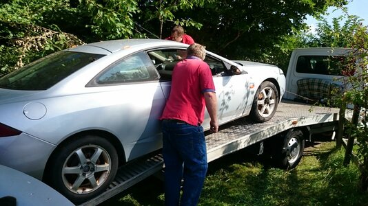

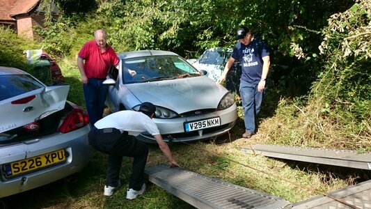

Loading up on the winch:

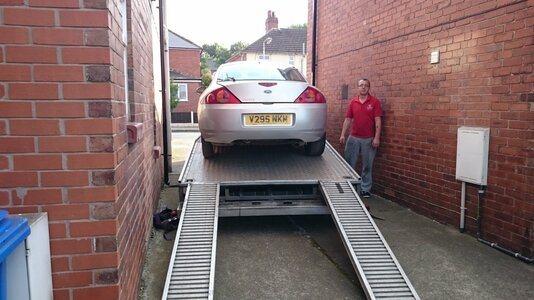

...after a 2.5 hour drive, we finally get to unload:
...and yes, it was as much luck as judgement i put the car into the garage and not through it. NO BRAKES :stop:
Ok so here it is, the subby:
Passenger side rear sill is solid except where the hammer went through and seriously, i hit it, not much more anywhere here as the hammer bounced off all along the sill:

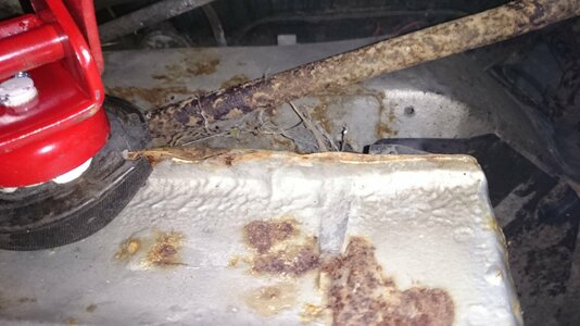

Drivers side rear sill looks grotty but this is solid, notice the jack:

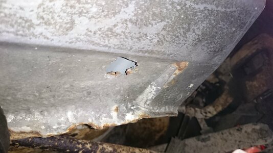

Passenger side front sill is holed and will need some plating:

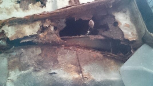

Drivers side front sill is bad, i mean bad.

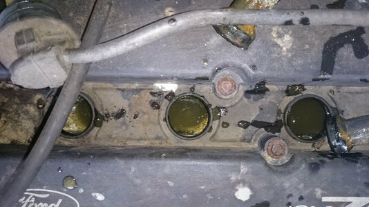

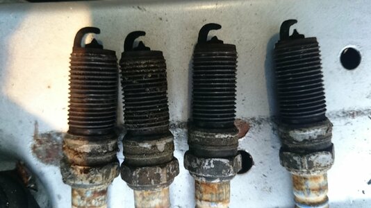

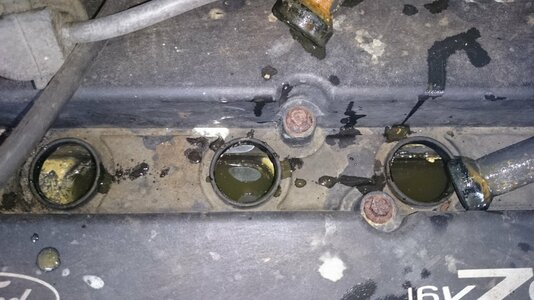

Now the engine and why i think it may have struggled to fire up, but having removed the leads, it's a miracle it fired at all :eek:
Somewhere under that i found these after soaking up the water and blowing out the recesses with the airline:
Needless to say, i replaced the plugs with a spare used set i had in a drawer ready for the re-start when i get a used battery.

It's amazing it runs so well once it starts, they ought to consider these engines for mini subs :). It should start a lot easier with the new plugs and a fresh batch of petrol. Fuel filter also will be fitted providing i don't find too much more of the flaky stuff.
