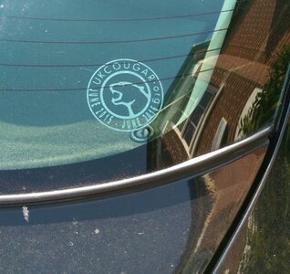

To cheer myself up, I then decided to stick on my nice new membership sticker (thanks Pid_16V) - thought I couldn't possibly mess that up, then had a heart-stopping moment when I peeled the backing paper off and one of the "2"s came off with it. Some delicate work with some tweezers later and I rescued it :) :
However, I was then so focussed on getting it stuck on right that I made no effort to get it oriented how I wanted, so it's not quite as I'd like it but at least it's not upside-down or anything.
