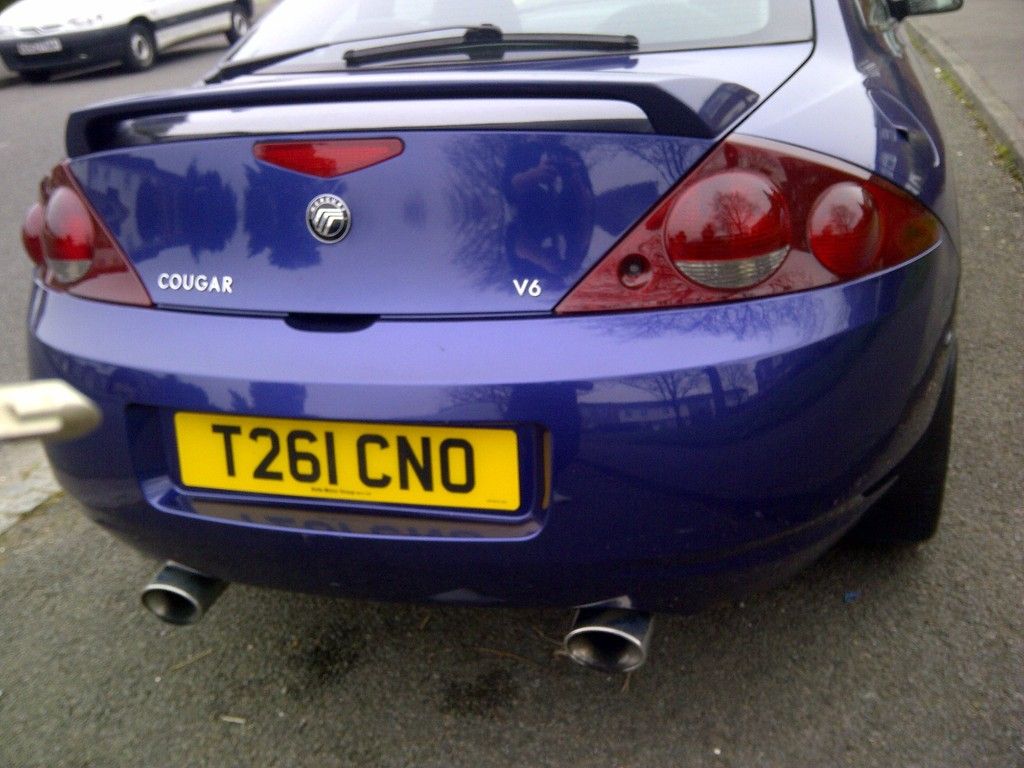

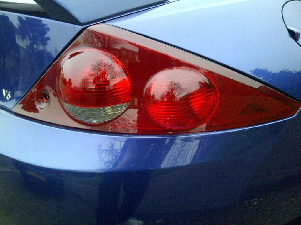

fitted these today with new led bulbs.
also fixed my lights and clocks breakdown that stopped me going to combe today.
was all caused by a faulty battery:shock:
would intermittantly go open circuit causing the alty to spike the electrics...and leds being very sensitive to voltage spikes were the first things to fail..
new battery on and new lights and all good...now i just need to get my new speedhut inverter.
many thanks to andy for these...they came up well andy:beer:
