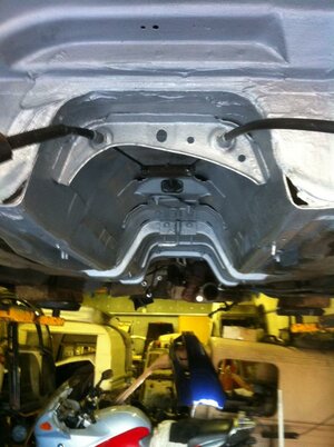

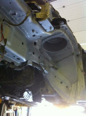

Treated and painted the tunnel and front wheel arches.Changed the clutch complete which was just about down to the rivets! Next up
brake pipe replacement and welding up the front jacking points which have rotted away!! I agree with the posts about if you want to keep these cars alive they need major surgery underneath, have a good poke about under the peeling under seal and in all the nooks and crannies its amazing what you find. Good luck to Topcat, doing a sterling job!!
Speaking of sterling jobs lol thats awesome under there Mick, not sure mine is getting that sort of treatment, but it will get a fresh coating of stonechip at least lol am also heading towards the rear brake pipe territory soon, am thinking of rerouting tho so they can at least be inspected, mine were on the verge of failing to the point of when i removed the pipes from the multiclip by the fuel tank, the pipe cracked further up and started leaking............Chris spotted it just before he removed one of the calipers........scary thoughts!!!!!!
