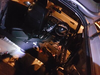

All interior apart from dash is now unbolted![]()

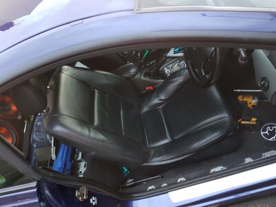

Yes, others who have changed to C2 seats have had problems with the three connectors being a different size from their C1 ones.
Ford changed the looms iirc late 98 - early 99. I've had to convert seat wiring both ways at different times.
pretty sure that was one of the differences in return style and non returnstyle injection type cars. Jane started life return style and got converted. I actually can't remember a harness between the two cars that was the same. Ford redesigned alot more then the fuel system.
