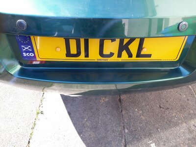

Car 002.jpgNo more unsightly blistering or peeling of paintwork around my number plate. Fitted my old C2 bumper. Still have to get the No Limits lip bonded on and it needs re-painting.

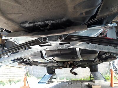

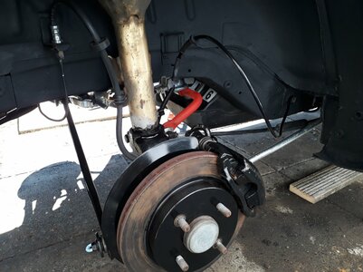

Car 004.jpg New sub frame finally fitted after having to remove it to fit the tank. Looks pretty good under there.

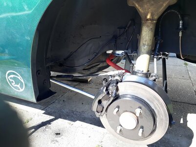

Car 006.jpg Galvanised drag links also looking good.

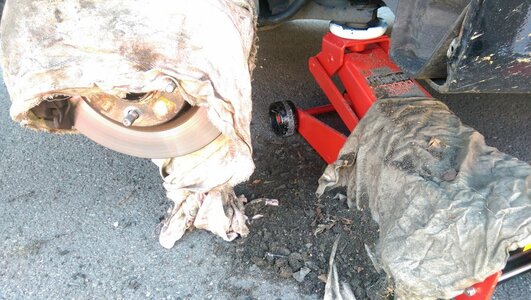

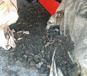

Got under my nearside front arch today, removed the plastic liner and all this fell out:

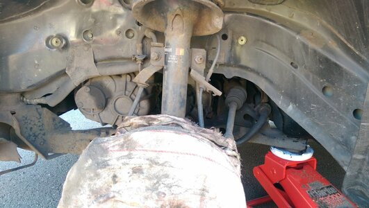

Under the dirt it's all pretty solid-looking:
although I'm gonna need a new front wing before too long, there's a bit of rot at the bottom of the arch (where most of that crud was sitting).
Slapped a load of Hydrate 80 on and put it back together. I was gonna do the other side too, but the heat got the better of me again (plus the smell of Hydrate 80 makes me want to vom for some reason :sick:). Something for next weekend I guess.
They fill up like that in no time at all, Mart. And the fact that the wings are tissue-thin at the bottom just compounds the issue. Good work though, fella!

I remember first time I emptied out behind the wheel arch OMG. Now I hose it out regular, after a bit of silt it clears and I check it all drains OK. I haven't took them off again since so I hope it's all OK behind there still.
