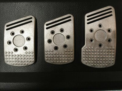

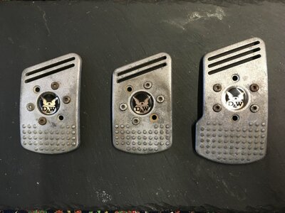

The freebie foot pedal covers have cleaned up very nicely. I found that continually changing the direction of wire brushing and trying to adopt an elliptical motion kept brush marks to a minimum. Also learned a lot about hex socket screws. I think the originals were imperial, as none of the 'dims' made sense. M4 x 6mm 'low-head' A2 stainless and M4 'thin square' nuts on order for the replacements. I have some 'doming resin' somewhere, so will try printing some mini Cougar badges for the new centres. I may not have saved a lot here, but I have at least found something to do inside in the warm !
To be continued...
