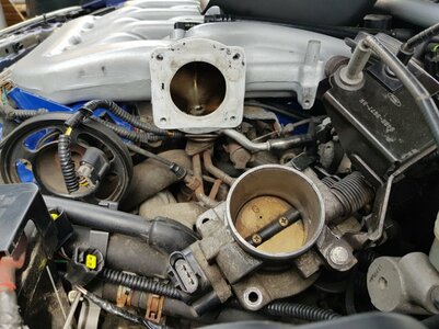

Well, I had a hunch that the difference in performance between KRM and KGV was more than just 'character'. Fortunately, Tony had given them both a drive and confirmed a dramatic difference between the two - 'Needs some work' I think were his words. Today I believe I may have found an answer. Low torque at low revs AND no 'kick' at 3,500 rpm both seemed IMRC related to me. So I had a little poke around, I wasn't even sure if the secondaries were wired in fact.
Well, an initial look inside the IMRC itself seemed to show it had not been opened and therefore I will be looking to check and properly heatsink the transistor at some point. However, a simple test of applying power to the motor showed something further on was jammed. Also, when trying to apply 12V to the motor, I found that I had to go a long way to get an earth. IMRC case ? No. Mounting bolts ? No. Engine block - NO ! I had to go right back to the battery terminals - further investigation required.

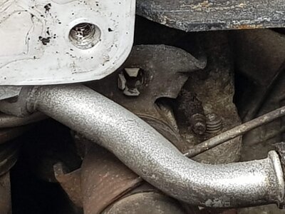

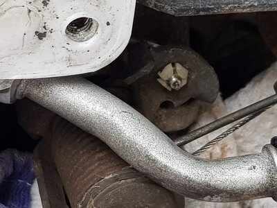

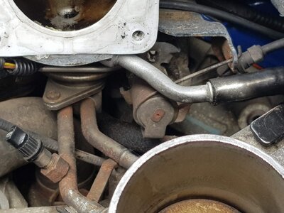

So I decided to have a look under the throttle body and around the IMRC linkage. Having gained some access I could immediately see something odd with the linkage. Look carefully at each picture before moving on to the next - a keen eye may spot it on the first pic. If you can't see it on the last pic, an appointment at Specsavers is recommended.
Now this is good - not only is the rear bush broken and the link arm dropped out, but the link arm is jammed under the rear secondary actuator that attaches to the cable and the rear actuator is being held in an intermediate position. Therefore both are suffering from 'Grand Old Duke of York syndrome', neither open nor closed and not even the same as each other in this case...

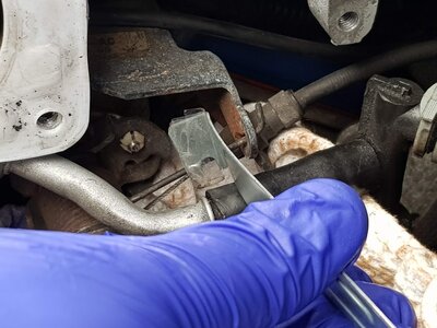

I could not find the spare plastic bushes anywhere. But all is not lost, I have a spare engine after all ! Let me tell you at this point, I found it nigh on impossible to remove either one of them. In the end, having of course first removed the linkage, a 5mm 1/4" square drive socket did the trick, but needed much fiddling and a cloth underneath just in case it fell. Here is the correct setup with plastic bush and linkage back in place :-
Please note the spring has also been refitted - If you compare to the 2nd photo below, it seems to have jumped over the cheek of the plastic guide at the end of the spring. Its back for now, but I don't know how long for.
Here is the computer slot bracket, complete with sticky tape that I used to fit it :-

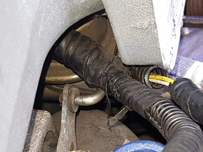

...and here is the next problem that might have led to the issue. Looks like I am going to be revisiting this to replace the old and fragile cable protection at some point. For now I'll just heave it up out of the way of the linkage with a few tie-wraps :-
