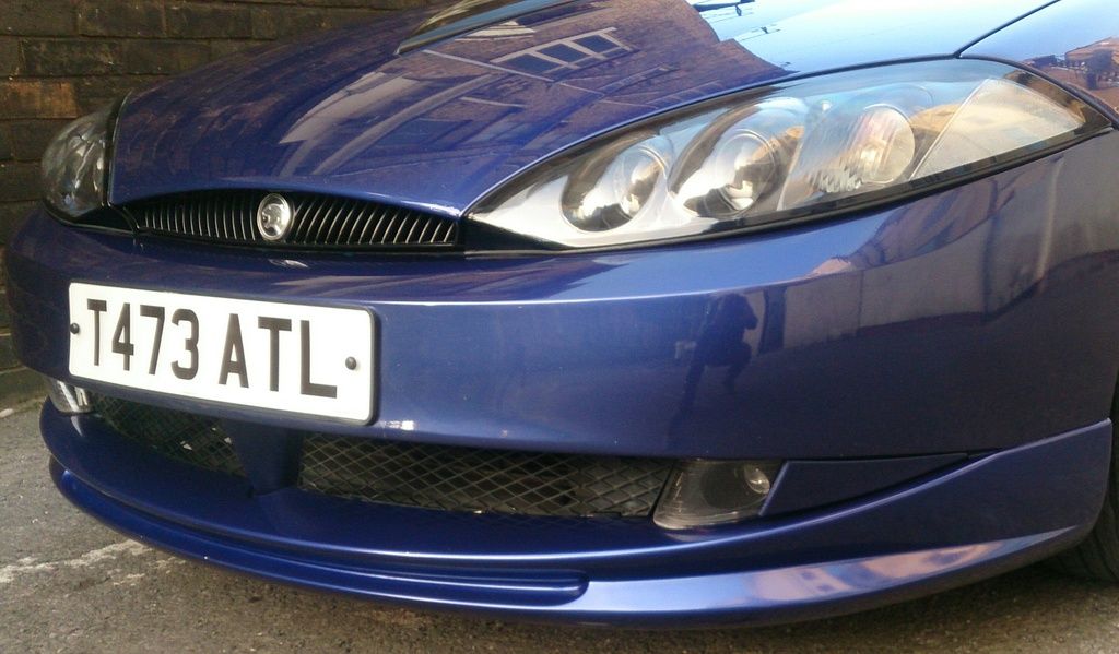

Ooh forgot to say when I posted this pic up, that I have managed to clean up the rear roof panel after losing the top rear eyebrow spoiler last year. You can't tell it was even there. I used a fluted toffee wheel to remove all the tiger seal.
Good lord that's beautiful. I can only hope that excellent photography is hiding defects. Because if it's not, I have a lot of catching up to do. Either way you should be very proud.
