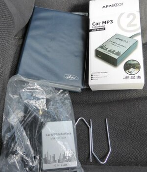

In the box, there was a warranty card, generic instruction sheet, aux audio cable and the device itself:-P1150163.jpg
I had previously acquired the Ford audio removal tool also pictured and required for fitting.

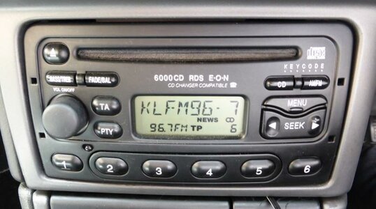

My Cougar has the Ford audio 6000CD RDS E.O.N with the all-important "CD CHANGER COMPATIBLE" label;-
Here showing normal FM radio reception. The built-in slot single CD player works and I have used it before.

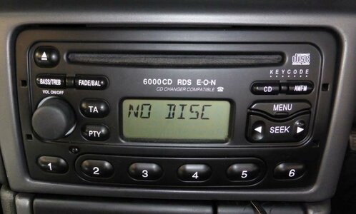

Here showing that the slot is empty/that no multiCD player with disc in attached.

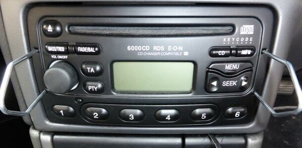

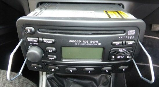

First, move the gearstick back (to eg. 4th) then with the radio off, insert the two audio removal tools into the holes on either side of the radio. Push them apart to release the catches whilst simultaneously pulling toward you, the radio should slide out of the console.
Once it is fully out, unplug the aerial cable and turn the radio towards the vacant seat so you can access the rear.

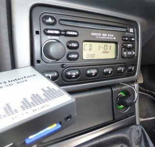

This just illustrates it connected.
I then fed the plug/cable up from the passenger footwell into the centre console behind the ashtray. Ensure to feed it under the radio supporting bracket and up the right-hand side before connecting to the radio:-
Reconnect the aerial and refit the radio, taking care to slide the plastic bracket on the back onto the metal supporting bracket in the console aperture.
Insert your SD memory card or USB flash drive with music files on into the socket on the device, and all being well you can now play these out through the Ford audio system.
Treat it just like a six-CD player; press the CD button to switch to CD/internal CD, and the number buttons 1-6 to choose virtual CD (folder), and seek <> to change track, AM/FM to switch back to radio.
