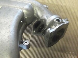

Do you know what the model number is for your 220 one?
I can't find a definite source for the number but the 220 one has 'squashed' hexagonal shaped ports, not circular ones.
Does Gem's Cougar have the smaller LIM?
