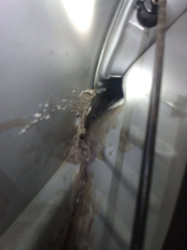

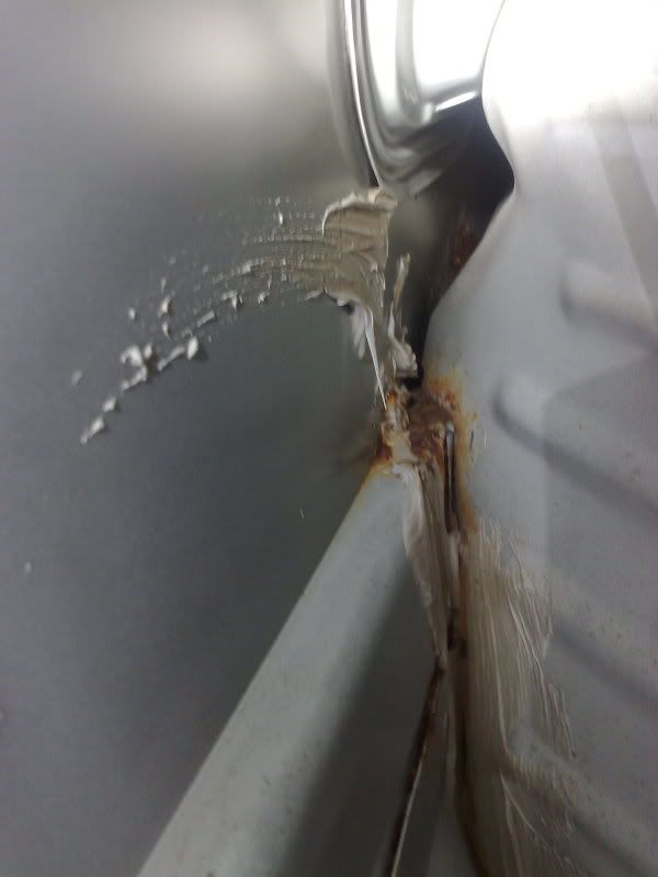

When I got my second 600 (a 37k mile L-reg 620SLi Auto - for £540!!!) it was, like most 600s, absolutely immaculate but for one rusty back wheelarch. When I went to tackle this the steel was thinned for a long way around the actual perforation, from the inside as we all know. This prompted me to pull the boot liners out of my R-reg iSD which didn't have rusty arches - I was horrified at what I found inside.

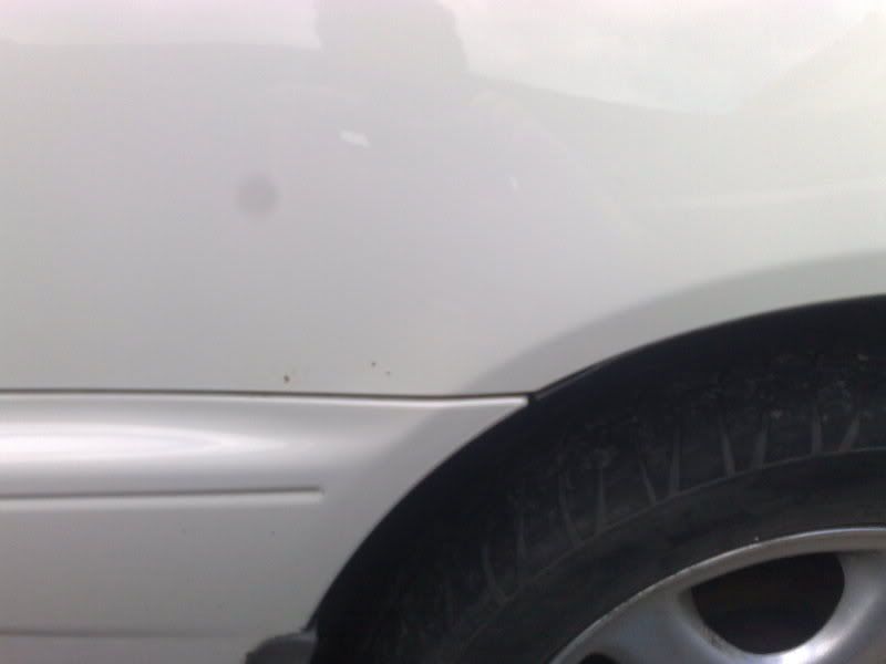

Similarly, this white 620 has little rusty bubbles on one wheel arch, so I knew what was going to be lurking inside. There's no such thing as a 'tiny bubble' on a 600 rear arch - so forget the power washing - if you haven't already done so, pull the boot liners out and get inside!
Doesn't look too bad eh?
Try inside:
After ages with the Dremel, a file and some emery paper the remaining still was thick enough to save (I hope). I plastered it with Kurust. This will hopefully keep the rot from advancing any further, and if I'm lucky will mean just a little bit of filler and paint to fix the outside. I left the iSD too late and had to weld it :o.
It's uncomfortable work.

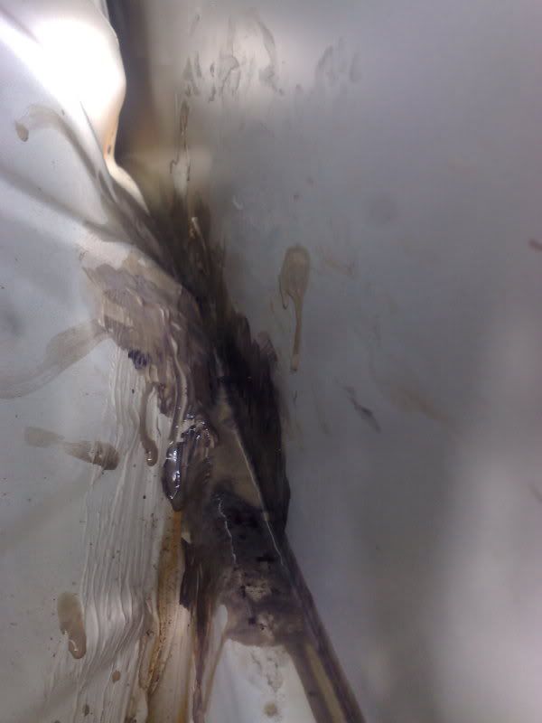

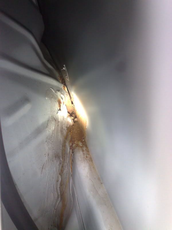

The passenger side is worse, with the electric arial and a cut-out missing from the inner wing, as well as the filler neck in the way. Fortunately here, whomever was sealing my car in the factory managed to get some sealant all over his hands - which he smeared all over the inside of the wing and prevented much spread of rust. Pity they didn't all do that!
These rear wheel arches are the only part of the 600 series that's prone to rust. Apart from dents and scratches which one can hardly blame the car for, the bodies are usually spot on on these cars - apart from just above the bumper at the back of the wheel arch and at the bottom down by the door. An Achillies heel almost!

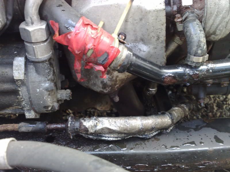

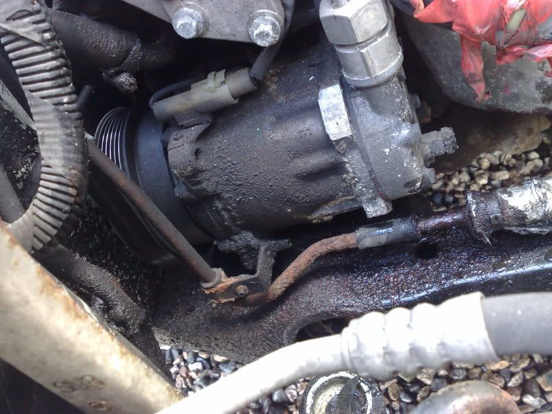

Life has been on double quick time recently (and well on it's way to getting a lot busier!) but just as we were toying with the idea of actually taxing and insuring the beast it wee-weed it's power steering fluid all over the driveway.
As my fellow rum-loving role model Captain Jack Sparrow might say, BUGG*R!

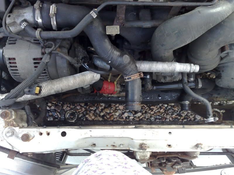

Well to get to the culprit corroded pipe the radiator, intercooler and air-con condensor assembly needs to come out. It's absolutely not difficult at all but it was one of those things I just couldn't be @rsed doing. I'd much rather be playing with model aeroplanes than faffing about fixing cars these days. It wasn't going to fix itself though, and it's an opportunity to fix a previous water hose bodge (got a receipt from a garage in all the paperwork for this marvel of British Engineering Incompetance).
Thine Holy PAS Pipe:
And this beauty is a "professional" job. W@nker...
The new pipe is here now, but guess what? I haven't had a chance to fit the poxy thing yet! Stroll on...

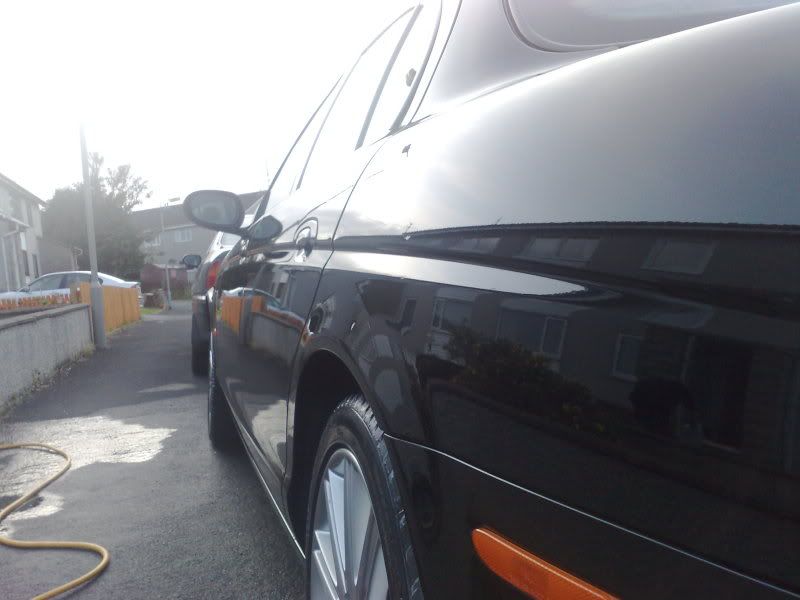

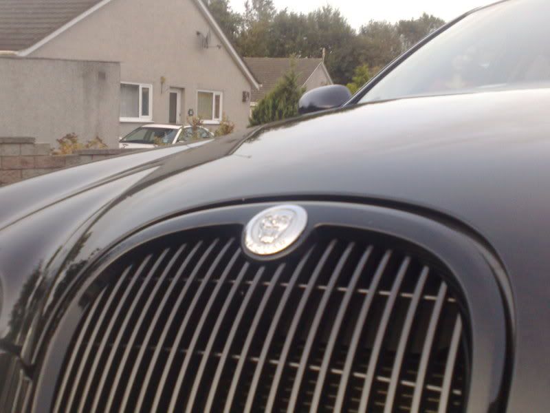

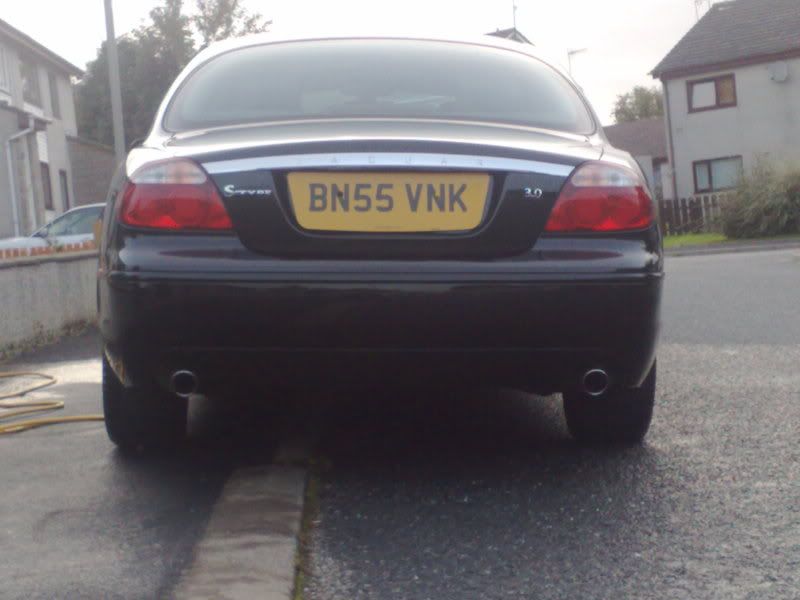

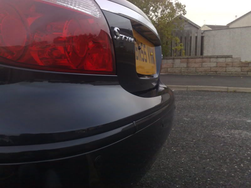

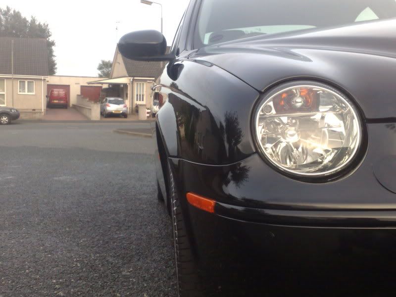

Tonight I have mostly (rather, WE) been cleaning the Jag for a special occassion this weekend. It involves driving all the way into Englandshire where this car came from. Anyone know where "BN" plates come from?
Anyway, we've even been cleaning resin polish out of the parking sensors for this, so birds be warned - keep your backsides sealed when flying near my car - at least until after the weekend!

Jamie you asked:
The answer is Bolton - Lanc's. Hope this helps.
ps. Nice Jag - thinking about buying an X-Type Sport 2.3 Diesel next year to replace my Toyota Avensis - just something I'm toying with...
Bolton? Oh well :lol:
My blue Rover is a Brummy, and my Jag is from a couple of hours up the M6 then...
