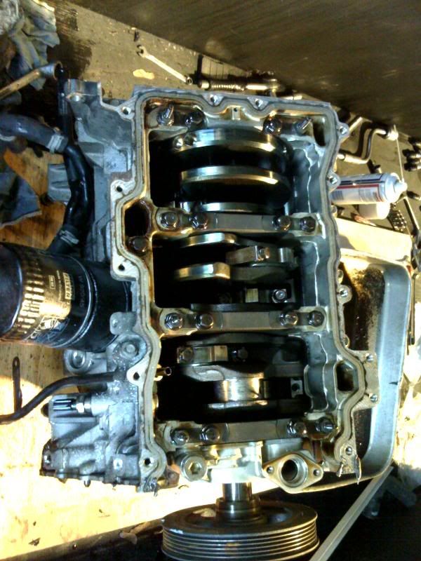

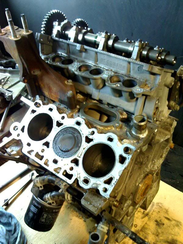

firstly the engine has to be removed and stripped...first the top end....
Then......the bottom end.....

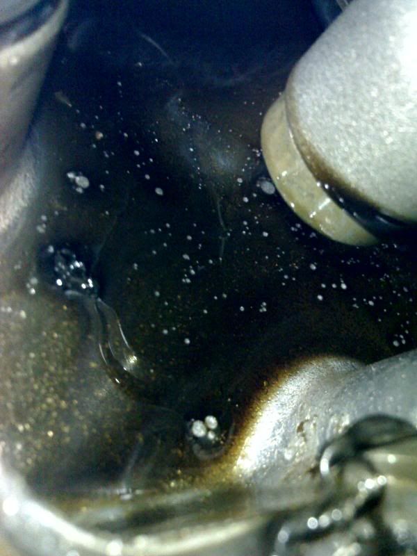

By the way......this is what happens to the oil!!!! Yep thats metal!!!:eek: :eek: :eek:

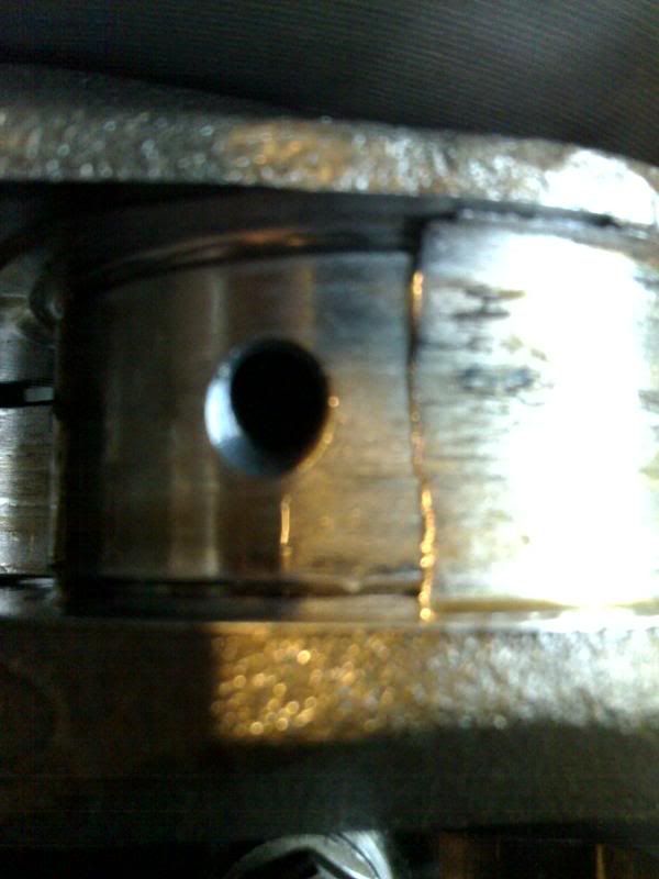

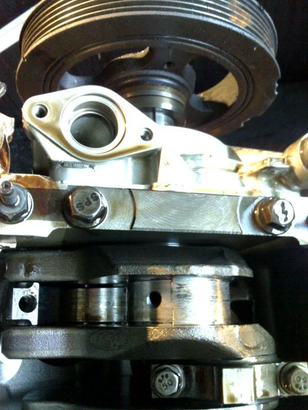

Which in turn kills this big end journal.....
This is a close up so you can get a real good look!! One of the big end shells had forced its way round the jounal overlapping the other one by about 90% :eek: :eek: :eek:
So the moral of this story ladies n gents is.....WATCH YOUR OIL!!!
