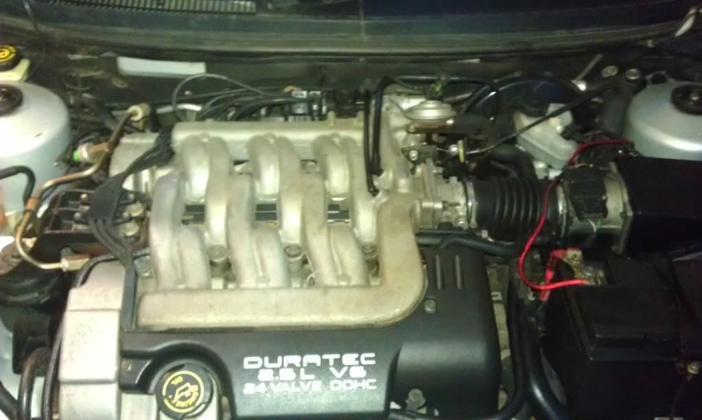

Before

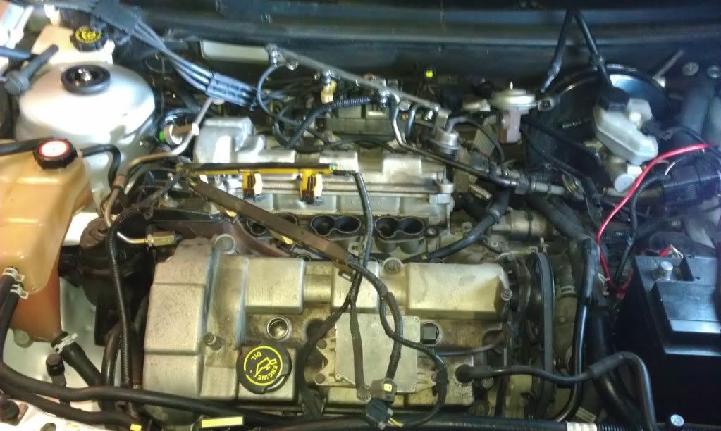

During

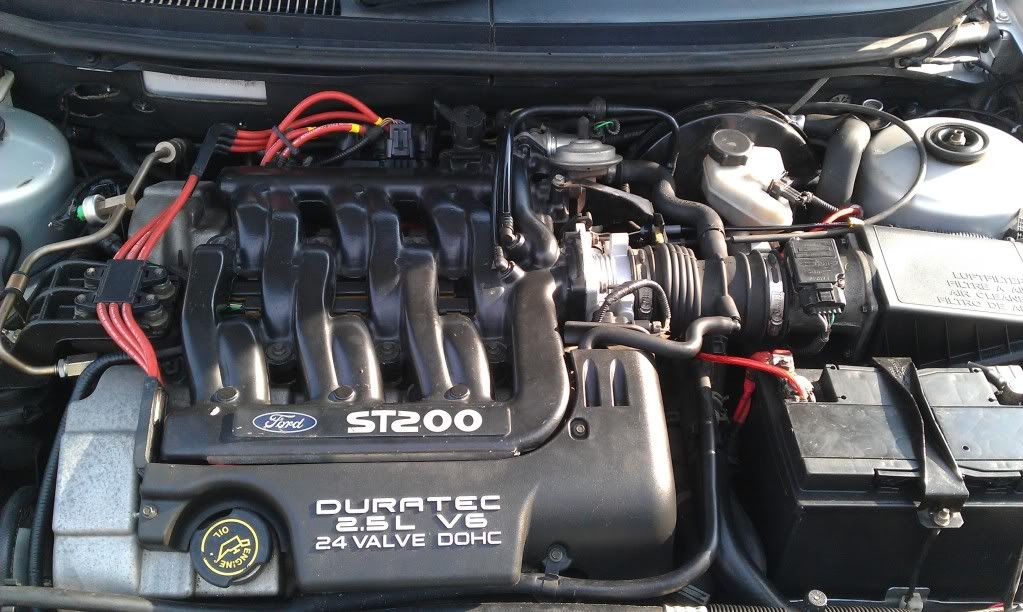

Finished Product...
Changing my Upper, Lower Inlet Manifolds and Throttle Body for ST versions, along with spark plugs to NGK Platinums and some Magnicore leads. Also fitted a cruise control servo and control cable.
Managed to **** up 3 injector seals by not paying attention, so went to turn it over and pissed fuel everywhere.
Took it all back apart and fixed with new seals and Vaseline.
Now have -
  • ST200 Upper Air Inlet Manifold
  • ST200 Lower Air Inlet Manifold
  • ST200 Throttle Body
  • ST200 Air Box
  • NGK Platinum Sparks
  • Magnicore Competition Leads.
  • Cruise Control! Oh YEAHHH
Cougar is now faster, smoother and quieter on the intake side, where it used to be really noise as the guys at Trax found out! Win :D

Looks great mate, but do me a favour - the OCD monster in me is pleading for you to turn your oil filler cap around so it's the right way up.....pleeeeeeeeeeeeeeeeease.....or I may just go insane(r) :blink:

Nice job Hip, is the ST200 mod worth the hassle?
Cheers guys. Rik, I can't really compare it tbh! I had had the car off the road for a few weeks and I'd been running round in the Smart car and I can't feel any difference from before. The one thing I do like is that the TB for the ST has a much stronger return spring, or less worn out and the Accelerator pedal feels far more response.

Normally it is the right way up, I had to top it up late one night and just put it back on. It's already been corrected :D
