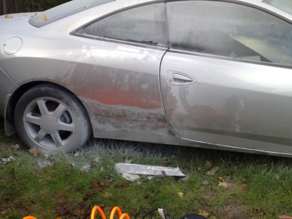

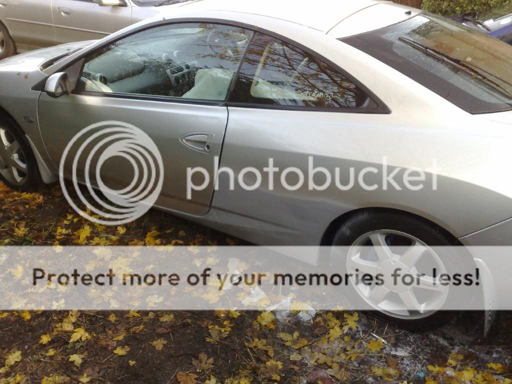

One of the biggest jobs was to remove the old side skirts that were blended in to the panel work and didnt look good , this job i will admit ive been dreading as body works not really my thing but i did promise paul i would have a go so finaly today with the sun out and the air temp at 5c i attacked the beastie with a grinder and a decent air sander , i started about 11am and finaly gave up and called it a day when my back couldnt take anymore at 4pm .

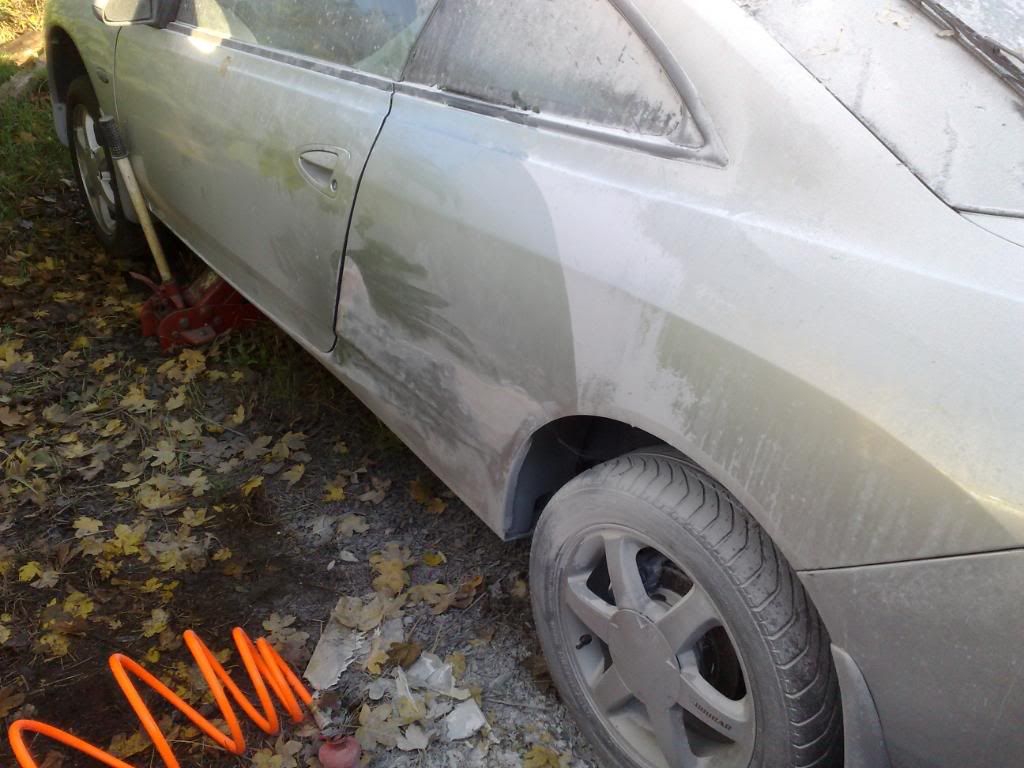

1st the drivers side

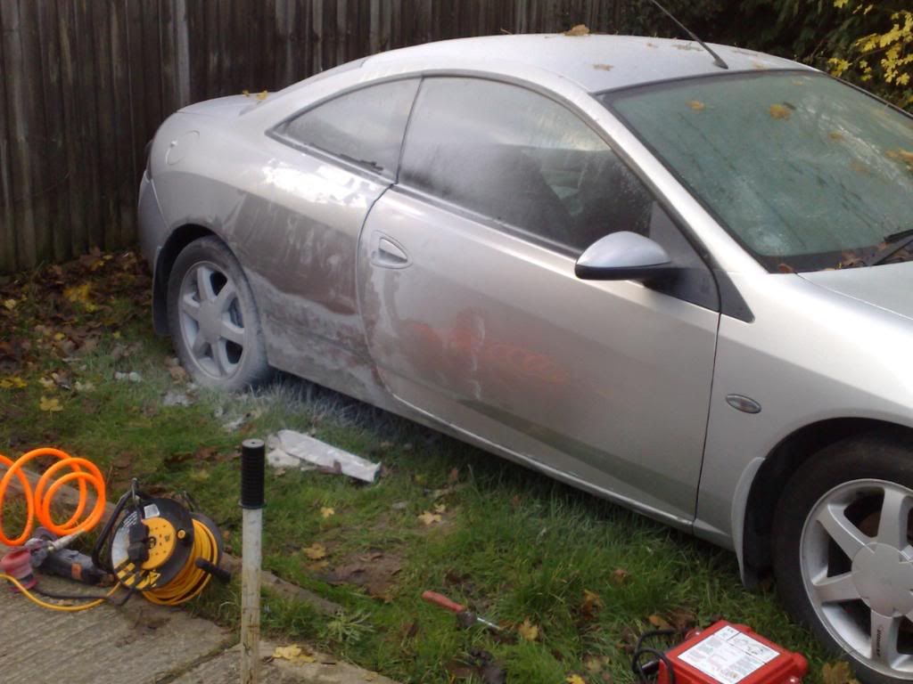

Then the passenger side
the filler on this side was about 1 inch thick :affraid:

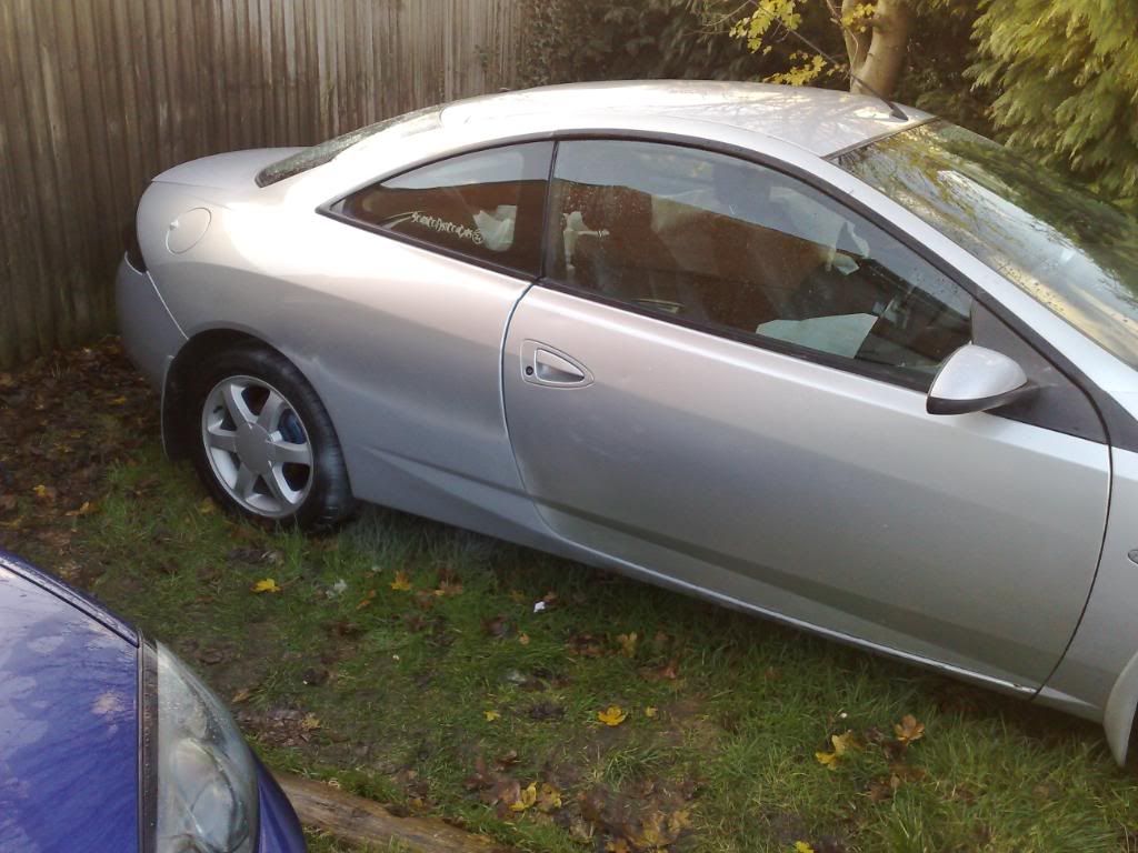

and then a quick coat of primer to stop any nastys getting in to the fresh metalwork
Now when i next have a few hours its on with the replacement Roush side skirts and rear valence then finaly off to paint

Yeuch... rather you than me mate! I do sometimes wonder how far sighted some people are when the decide to get this stuff done in the first place.
I recall one ex-forum member who got a full bodykit fitted, insisted that the bumpers, wheelarch flares etc were all blended in against most peoples' advice, then couldn't get onto the brake rollers for an MOT due to ground clearance, and couldn't just remove the front bumper either because it was now part of the rest of the car.
I guess I just kinda wish people wouldn't do things so 'permanent' to cars. It's always much harder to undo these bright ideas than it is to do them!
Hows the back? Bet you still can't feel your fingers...

How did you manage to get the paint to stick to the rear mud flaps?
The skirt looks like a very poor fit is there a reason for the gap just behind the front mud flap
V
V6Drifter
Yes there is a reason for the gap, we had two new wings put on and the bottom of the side skirts were taken off with the old wings!!!
as for the mud flaps i keyed them with a fine sand paper about 3-4 coats of primer 3-4 coats of colour and several coats of lacquer.

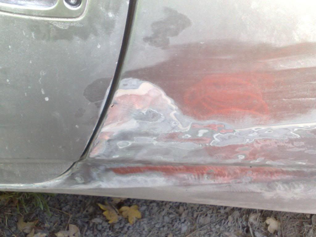

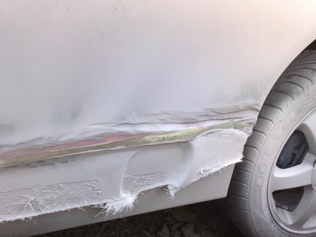

This is the only pic i've got from when we removed the towbar, and it really doesnt show what that butcher done to pauls car, it was bloody heartbreaking to see the look on pauls face whenever he looked at it!!!
This is massive praise to paul for holding out against all the odds, and hoping that someday he'll catch up with said bloke!!!
As for ian, mate you've taken on a massive task to bring pauls cat back into the land of the living, awesome job mate, i saw how much filler was on pauls car and cringed, but even i didnt think it was that much!!!
